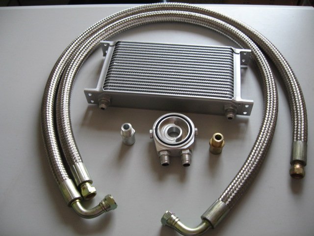

Yep, the cooling issues are definitely resolved. The "severe duty" clutch fan works very well. Roars pretty loud when its hot out, especially with the A/C on. One electric fan is set to automatically kick on around 200F. The other fan is set to automatically kick on around 210F. Plus both fans are wired into a toggle switch on the dash, so that I can manually turn them on if I want. You can also install an aftermarket oil cooler. It installs very easily. Takes about 15 minutes. One part goes between your oil filter and the engine block, and the mini radiator just zip-ties to your main radiator.
