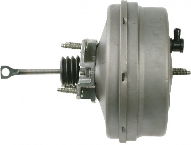

    Interestingly enough, because of a website clerical error, you would get paid $11.27 for every one of these that you buy, via rebate: The rebate exceeds the cost of the part.
Cardone 54-74833 Remanufactured Power Brake Booster
Was: $51.29
Price: $48.73 Free Shipping for Prime Members
You Save: $2.56 (5%)
Post-purchase rebate: $60.00 Rebate forms
Price after rebate: ($11.27)

$48 with 2 day shipping included. Verify fitment prior to purchase.
Except if you google the issue. Everyone says that "Service Brake Booster" will never be triggered by the brake booster. I have no issues replacing it if it fixes the problem. From everything I read there is nothing in the system to actually check the brake booster. The message is porely written and points to other issues.
It may not solve the problem, but its free to try. Better than free. You profit over $11 just by installing this on your rig. The rebate exceeds the cost of the part. I don't think it will solve the issue, but if your getting paid to replace it - why not give it a shot?
