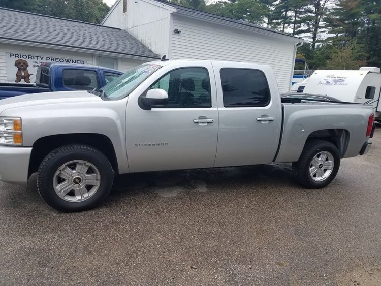

I have a 2010 Silverado, 5.3, 4x4 LT. The right low beam is not working. I have changed the bulb, fuses and relay. Tested all the circuits with test light, very little power to the low beam socket. I think I have found the correct ground and checked that too. I have power to the fuses. The only thing I haven't done is trace the wiring back to the fuse box. Anyone has any other ideas what could be wrong? I'm completely lost.
Thanks,
Tony
