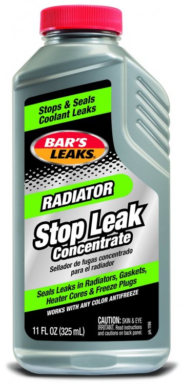

Now what's the problem with stop leak? I guess stopping flow where it's not supposed to?  I'm probably swapping the intake manifold with the info I have now.
   Problems with stop leak can include:
   Plugged passages in radiator, heater core, and small pipes/tubes in the cooling system.
   The grit can damage the water pump seal resulting in a leak that will not be remedied by the product.
   Decreased cooling system efficiency
   Red flag for anyone looking to buy your vehicle.
   Not 100% reliable short term or long term.
   The major advantages of these products:
   Extremely inexpensive
   Very easy to use
   Often works flawlessly and reliably
