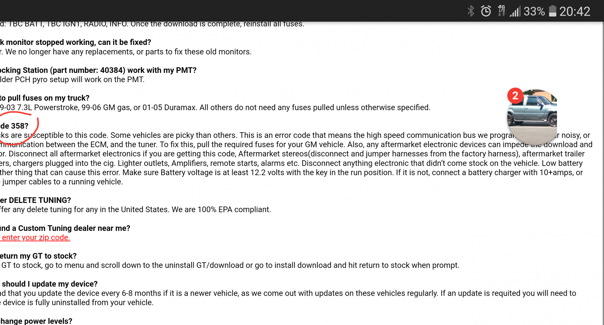

I went to load a tune into my 07 Silverado.  Normally I have no issues this time it got half way through the process and gave me a code 358.  I looked it up and it said that some tucks are more sensitive than others and noise on the can bus will cause issues as well as aftermarket radios.  I recently installed an aftermarket radio.  Has any one else had this issues and if so what was the remedy.  Thanks in advance
