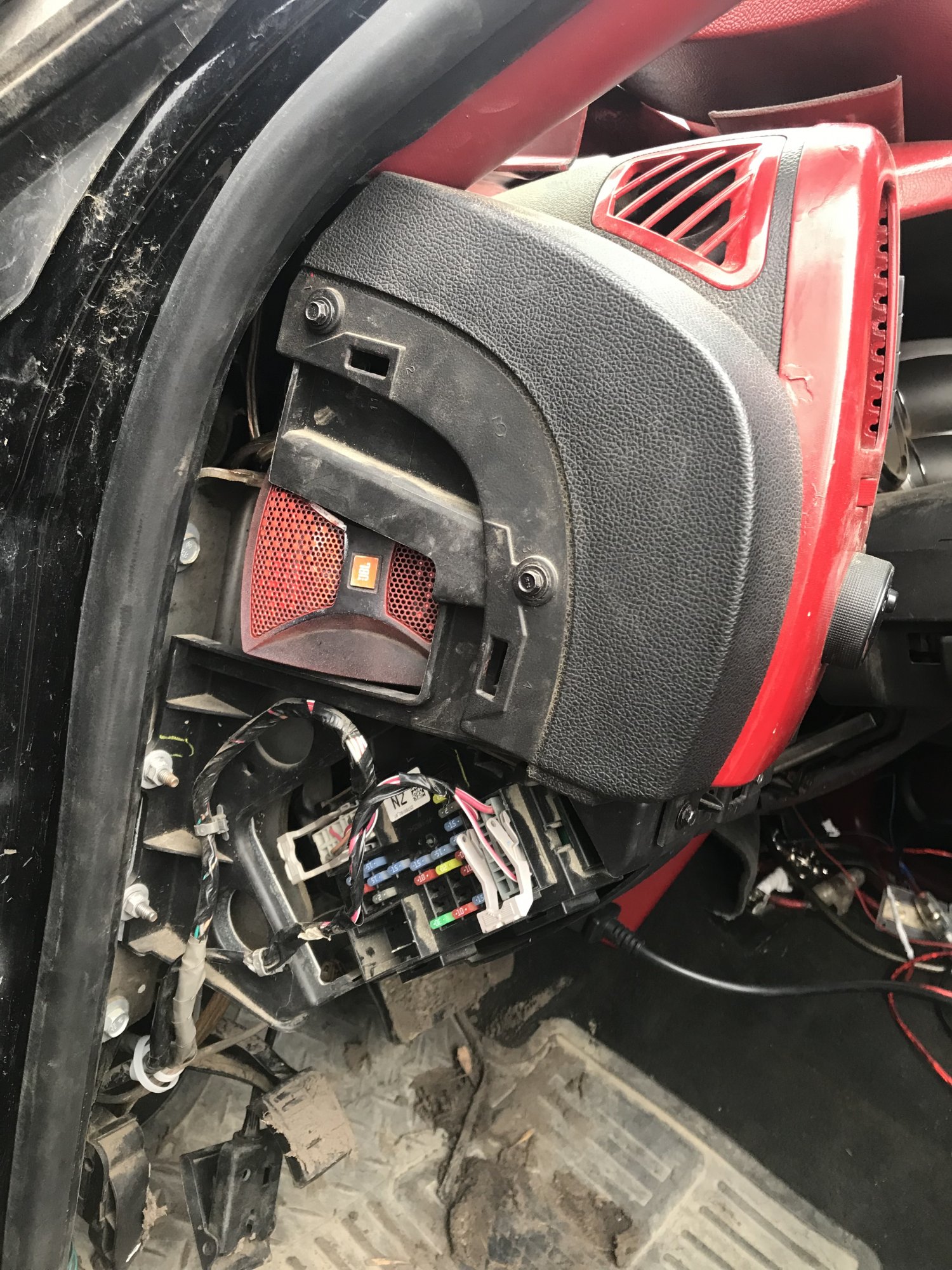

I just found a deadly spot on my 07 for pretty much the same speaker locations recently for my x-overs when doing some cable re-routing.  Behind cover for interior fuse box on driver side and above the actual fuse box there is a end of a piece of bigger metal tubing (which I believe is part of your actual frame for entire dash and same under cover on passenger side as well ).  There’s a roughly 1.5” space between pipe and plastic dash piece and probably about a 3”x4” opening which my xover just perfectly slid into, haven’t even had to secure them and was easy to get wires from a pillars for tweeters and from below as well and pull it out, attach all 6 leads and squish back in place inside with lots of extra room for speaker wire to fold back in(I ran all new 12-14ga speaker wire to every speaker from amp on rear wall behind back seat).
I have 6.5” JBL GTO compenent with 1” tweeters by the way, and that spot worked great for the xover.

Thanks. I ended up not getting them installed yet because as soon as I started, the wife informed me that our sump pump was not working. I spent the last bit of my free time plumbing. I'm going to try this weekend. Any pics?
