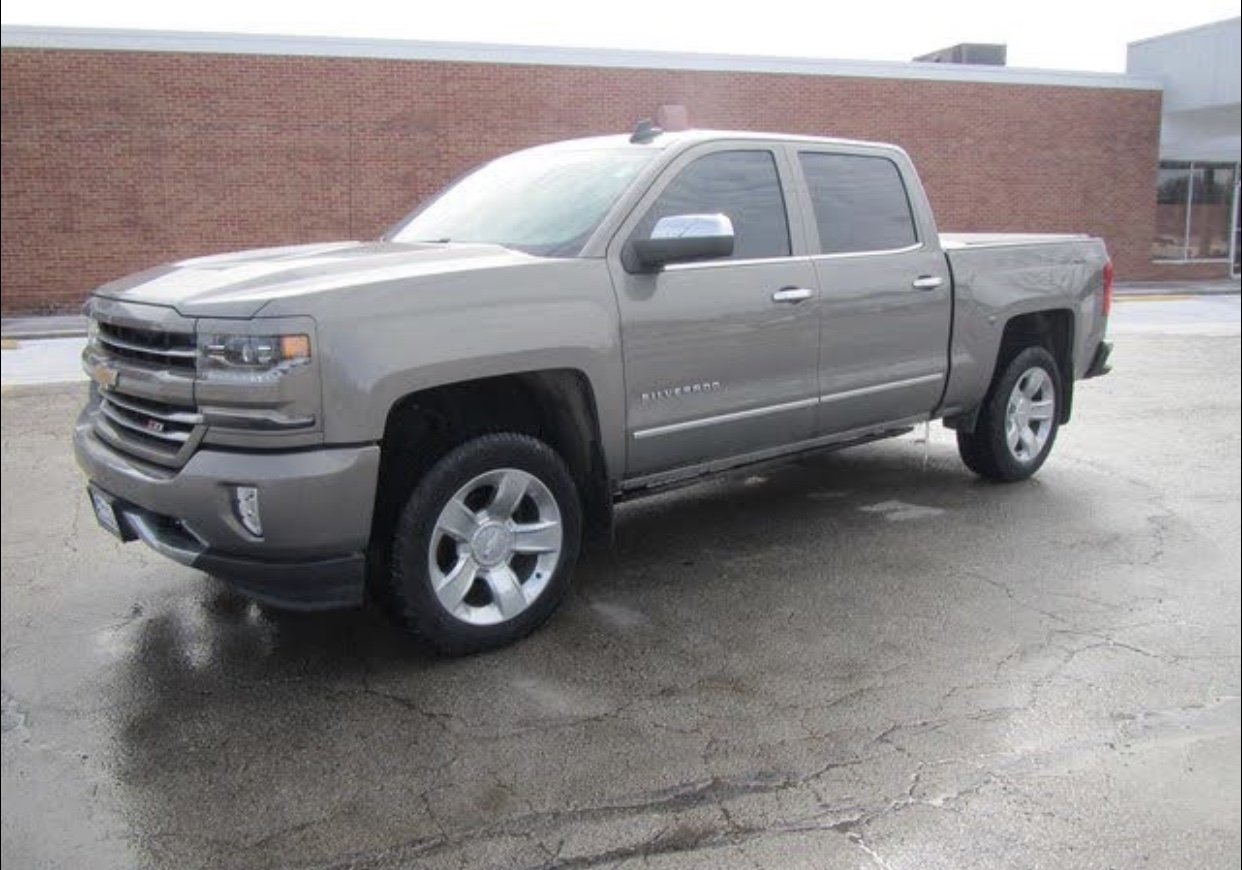

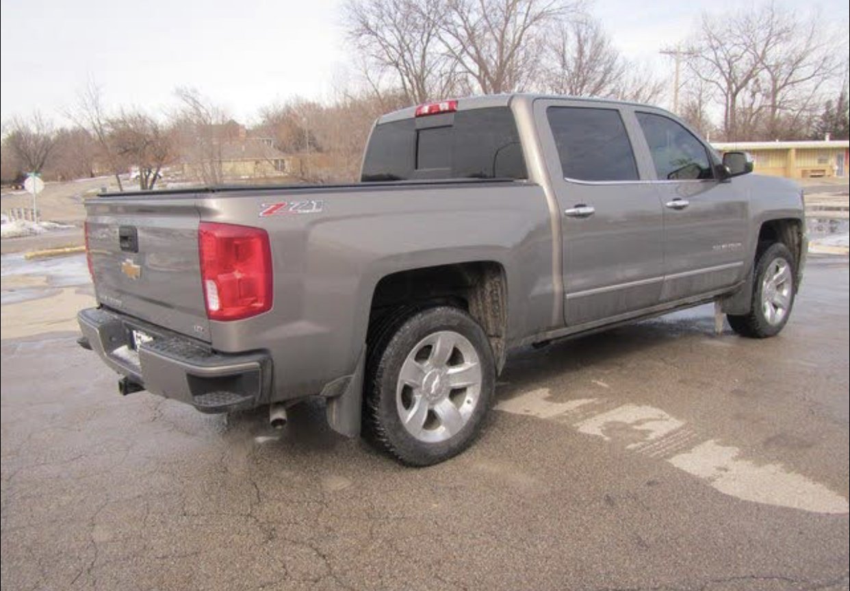

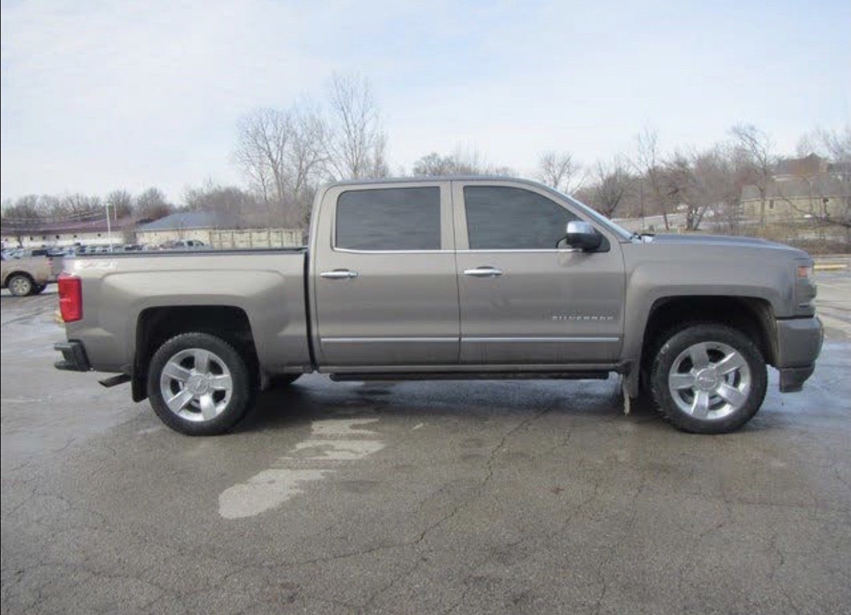

PLEASE HELP!! Anyone running 275/65r20 or 285/65r20 tires on their Silverado's? Currently sitting on stock 275/55r20’s and wanting to know the largest tire I can fit with minimal to no rubbing. Truck has a Rough Country 2.5” leveling kit installed.
This sounds stupid and backwards... BUT.....
From all the research I did, since you have leveled the fronts, you are running the largest tire you can already unless you replace the upper control arms.
If your front was STOCK height, you could go to a 275/60-20. But as soon as you level the front, it brings those upper control arms to a different angle and they will rub.
I'm running 275/60-20 on my stock height front end and all is well, but once I found out that on the 2016 and up trucks, you had to replace the upper control arms too, I just left it alone and lowered the rear end to "level" it while still having a slightly larger tire.
