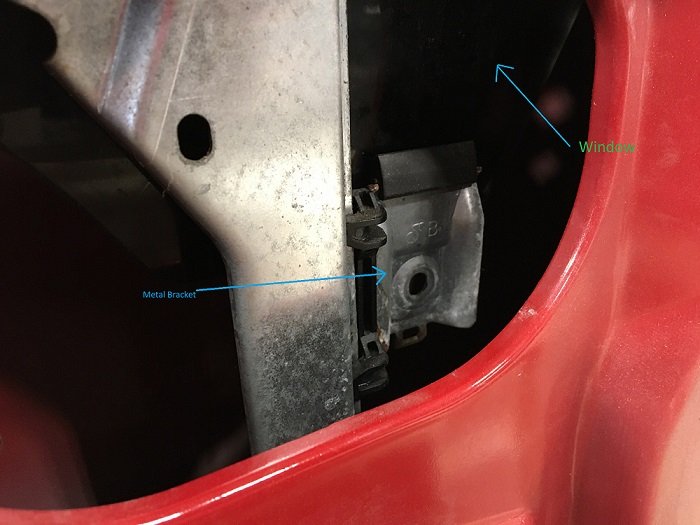

What is this window metal bracket called?
2013 Silverado 2500HD crew-cab 4x4 diesel
Pictured is a metal bracket that holds the bottom of the window in place (passenger rear doors).
There is another similar bracket on the other side of the window. A screw clamps both brackets together with the window sandwiched in-between.
I am missing the bracket on the inside, so the window keeps jumping out of its track. What is that bracket called? Need to know the name so I can order the part.
Thanks
I don't think that part is normally sold separately, it's part of the window regulator (either manual or power).
If you just want that one part, then I would suggest going to a junkyard and getting it that way.  If you want it new, then you'll probably need to buy the whole assembly.
