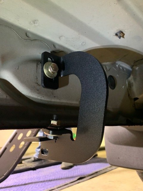

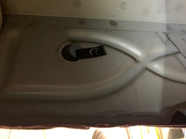

2. Located and familiarize your self with the brackets.  Depending on the brand of running board, some brackets may have special orientations for install.  In this case all 8 brackets were the same.  In the upper bolt location for the rear 2 brackets on each side of the truck, you will need to install the provided u-bolts in the side of the unibody frame. You may need to remove the existing u-bolts and replace with the new ones in the HST kit.
3. Install 4 brackets hand tight.  Use the Zinc bolts, zinc lock washer, and zinc flat washer on the top bolt location and the black bolt, flat zinc washer, and flange nut to attach the bracket to the trucks pinch weld.  Hand tighten only, you will want some movement to make final adjustments.

5. Make sure the running board is flat (parallel to the ground) then start tightening the bracket to truck connections first.  You can crank these down tight but not Hulk tight.  You will need a 13 mm wrench to get the pinch weld nuts started.
