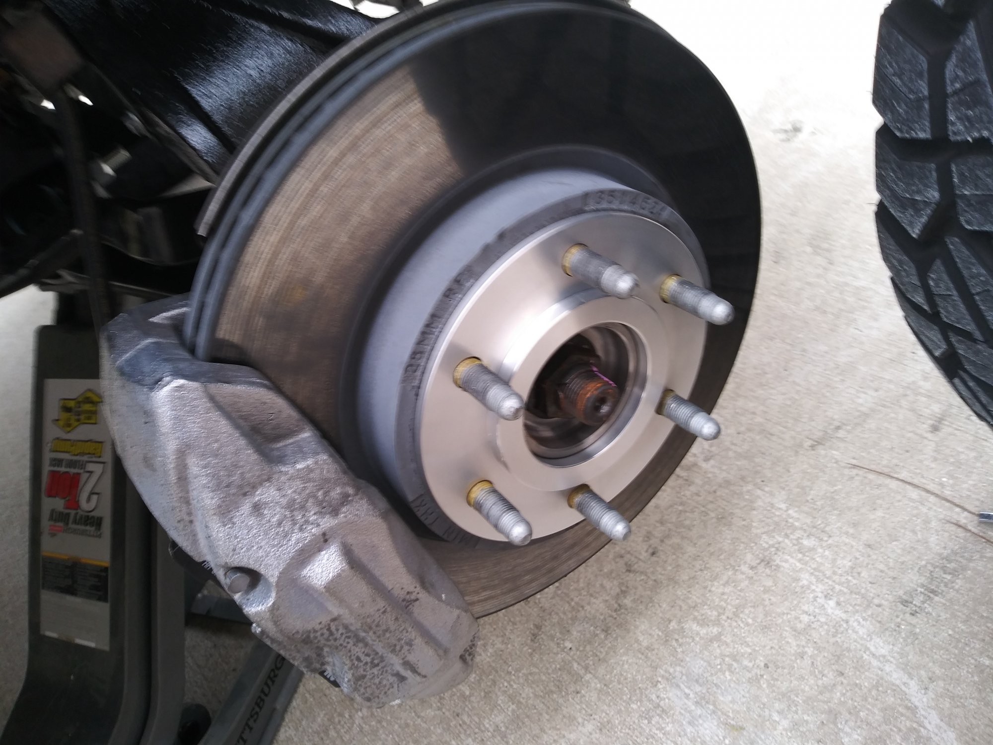

I got a mcgaughys lift for the truck coming in and I was curious if anyone here runs American force 12 wides? cause I’m trying to figure out if I need to run spacers to clear the caliper and if so what’s the best size and brand
I don't have Forces but Bora spacers are the best.
You can get them custom made to be both hub centric to your truck and wheel centric to your wheels. I use 6mm Bora spacers on front to clear the calipers.
3 hours ago, Mitchell95 said:
Are you using factory studs with the spacers?
Factory studs with extended length lug nuts.
