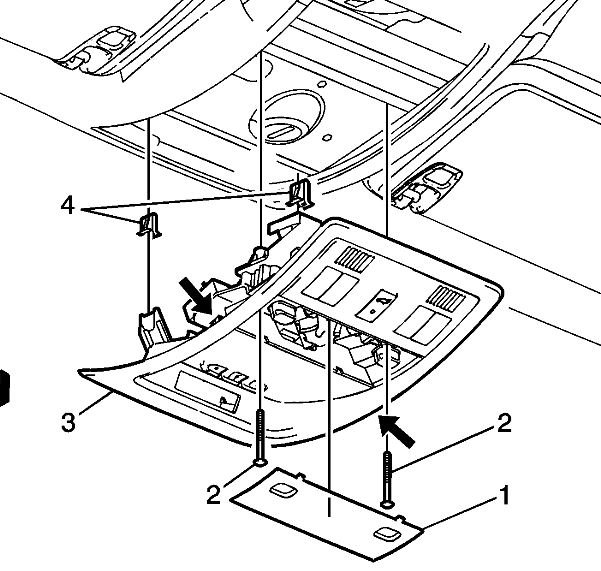

I have an early model 2014 Silverado 2500HD and would like to add a Homelink system, how do I remove the overhead console, don't see any screws and do not want to brake anything trying to remove it.
Remove the cover. Remove the 2 screws, Pull down.
