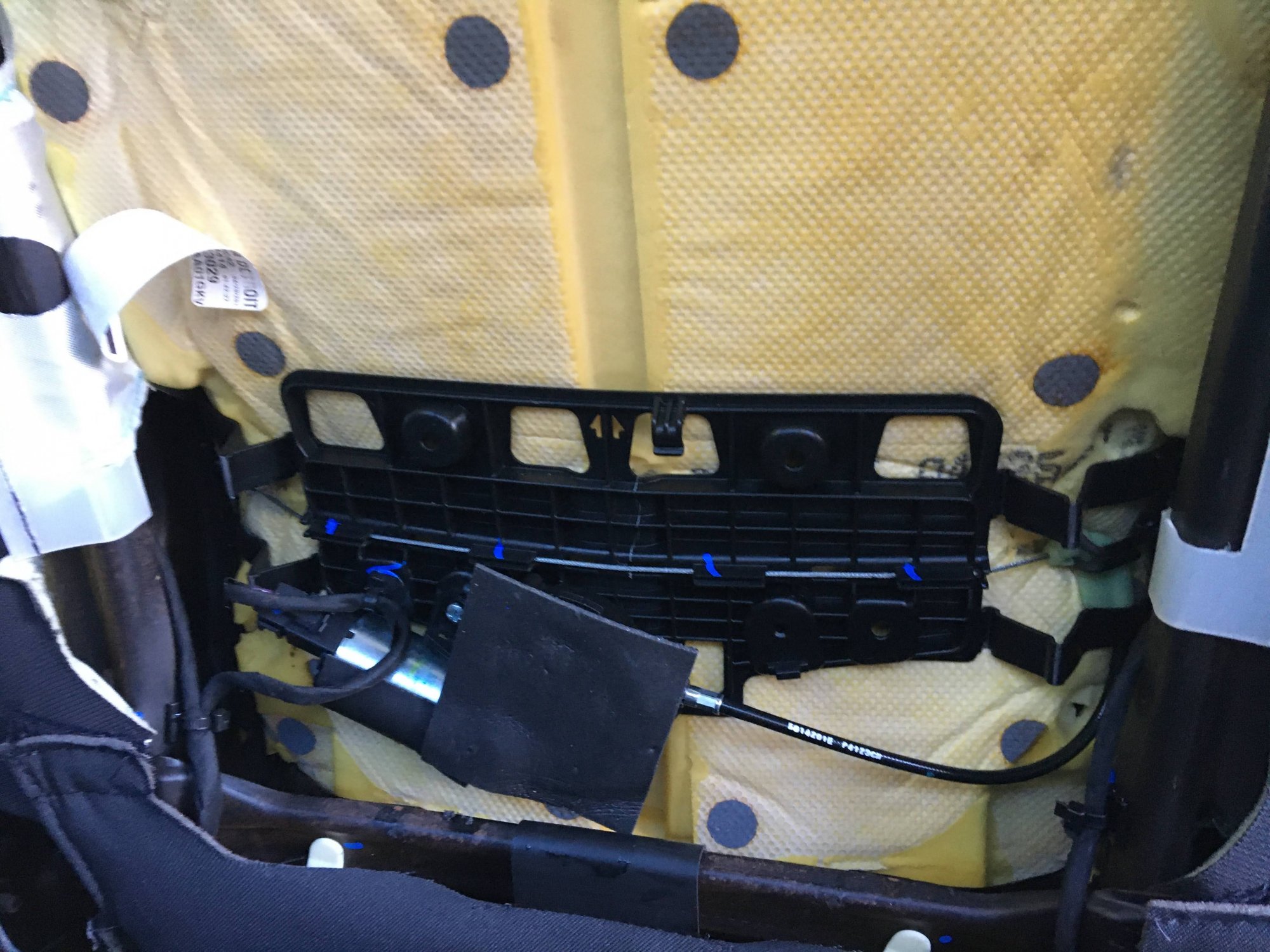

I have a 10-way power seat on the driver side and the lumbar support works pretty good.  So I took off the back panel to see how the power lumbar adjuster works. There's a plastic panel attached to the seat frame on one side and a motorized cable on the other.  The motor pulls the cable taught to increase lumbar support and relaxes to less support. On the passenger seat, that lower panel is a wire mesh attached by metal rods to the seat frame and it's obviously so slack that it won't provide any support unless the seat occupant is of very good size (my wife's not small but she's not big).  I found some packing material that came with a TV...it's not Styrofoam...it's more of that plastic webbing stuff...and shaped it to the right width and right thickness. I shoved that between the seat back and the wire support.  With a little trial and error, it's just right and very comfortable. Second problem solved.
