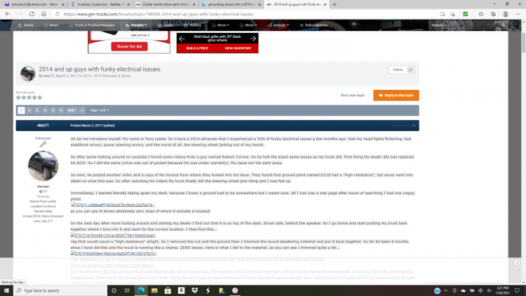

Start with this post, I will dig around and see if I can find more on the bad ground issues.
