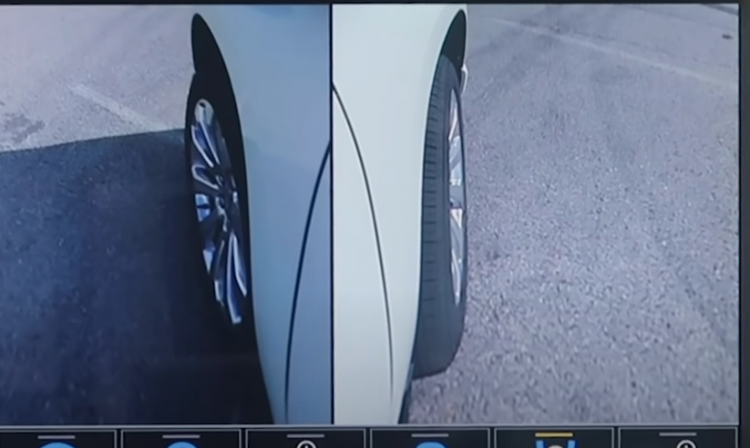

Let me guess, you have a sunroof.  Seems to be a common thing at least.  You get parking assist or sunroof (if not ordered)
Parking assist: Not worth the effort.  Requires new bumpers, mirrors, likely wiring harnesses
Surround vision: Not 100% sure on this one but know at the very least, you'll need a new high mount brake light as that is where the rear camera goes.  Pretty sure there are also cameras in the mirrors judging by this view:
So in the end, anything is possible.  Will you end up paying a crazy amount of money and need BCM programming?  Absolutely
Found this here:
Not quite as spendy as I thought but not cheap by any means

 Yes I have a sunroof! ... that sucks... well as for the brake light camera, I'm already planning on upgrading mine to that with the lcd display for review mirror.  It's about $1K but then prob will just go the intelihual 2.0 system if I do go with the camera system.  That way I can add a front camera.   Oh well I guess I'll have to skip on the parking sensor.  Thanks for the info.
