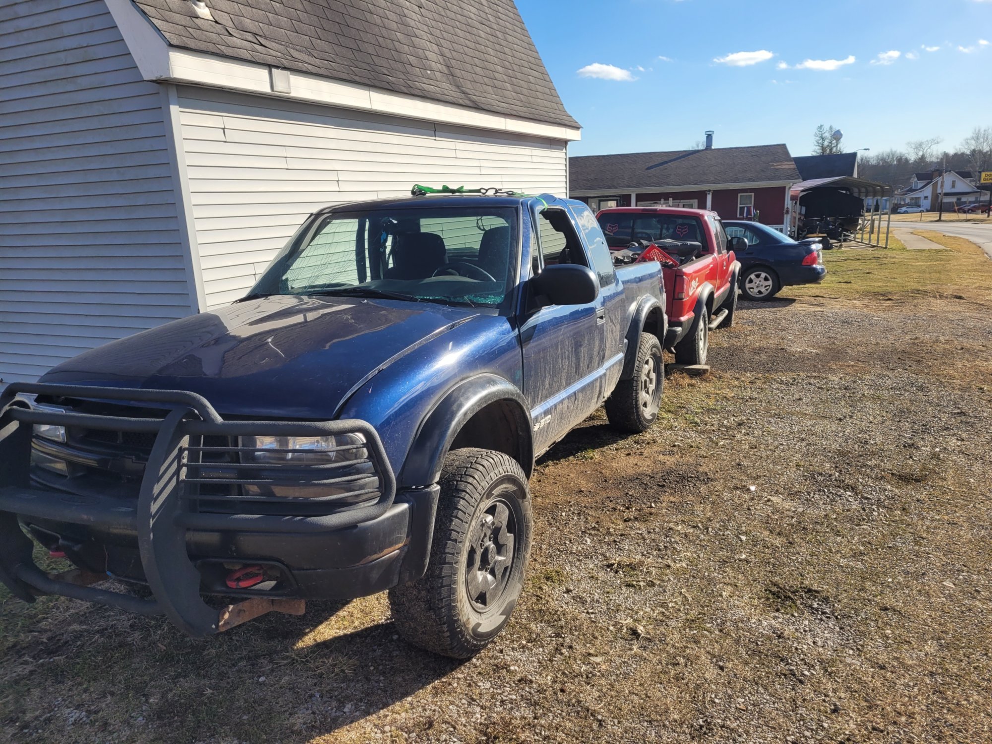

Hey guys, I have a 2000 ZR2, blown motor, shot transmission. I just bought a 2003 ZR2 to do a swap. My question is the compatibility on the 4l60e. Is it. Direct swap or do I need to change something for the electrical connection? I've read both and I'm trying to get some clarification.

See if both the old and new engines and transmissions have the same part number; this would be a start and the easiest to confirm with Chevy. You have to consider any PROM chips in the computers. A PROM from a pick up engine/trans will be different than the PROM in your ZR 2.
