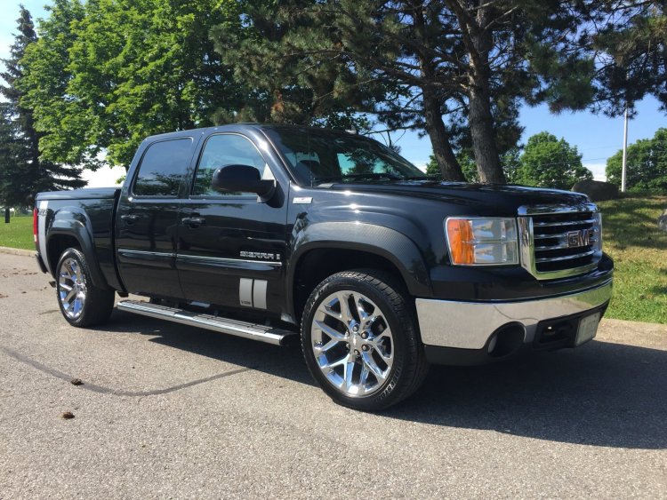

Yes. Not sure about your tire but these are 22s on an 08.

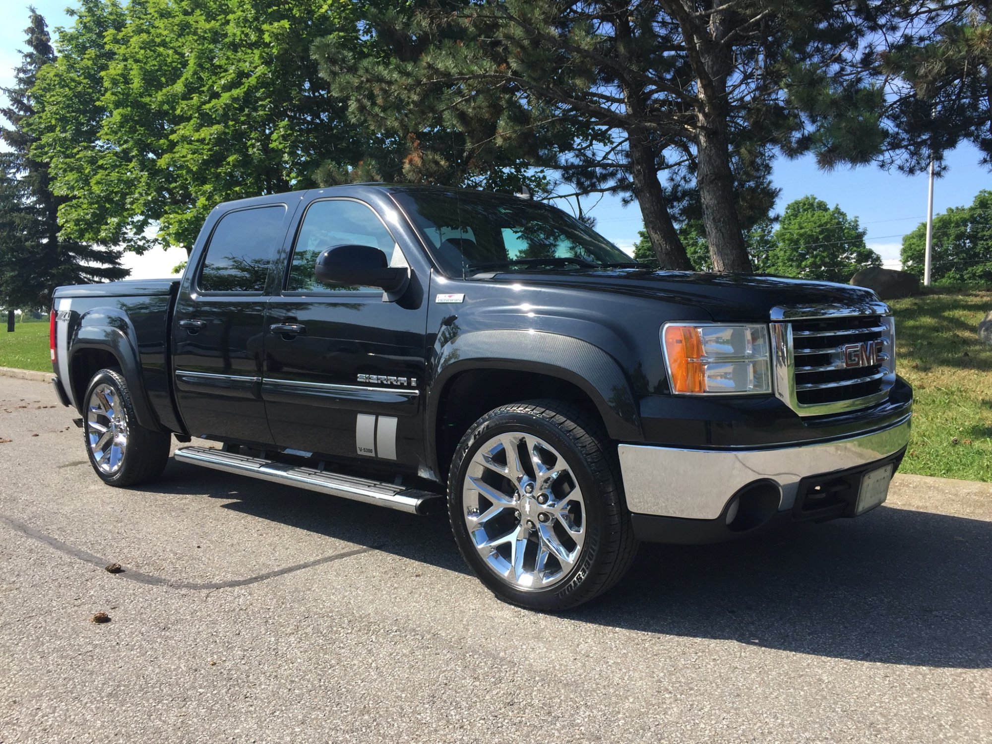

Thanks. I believe the tires will fit. I have 265s on the truck now. The main thing I was concerned about were the wheels fitting over the hubs and the brakes.
Those wheels look great on your truck.
