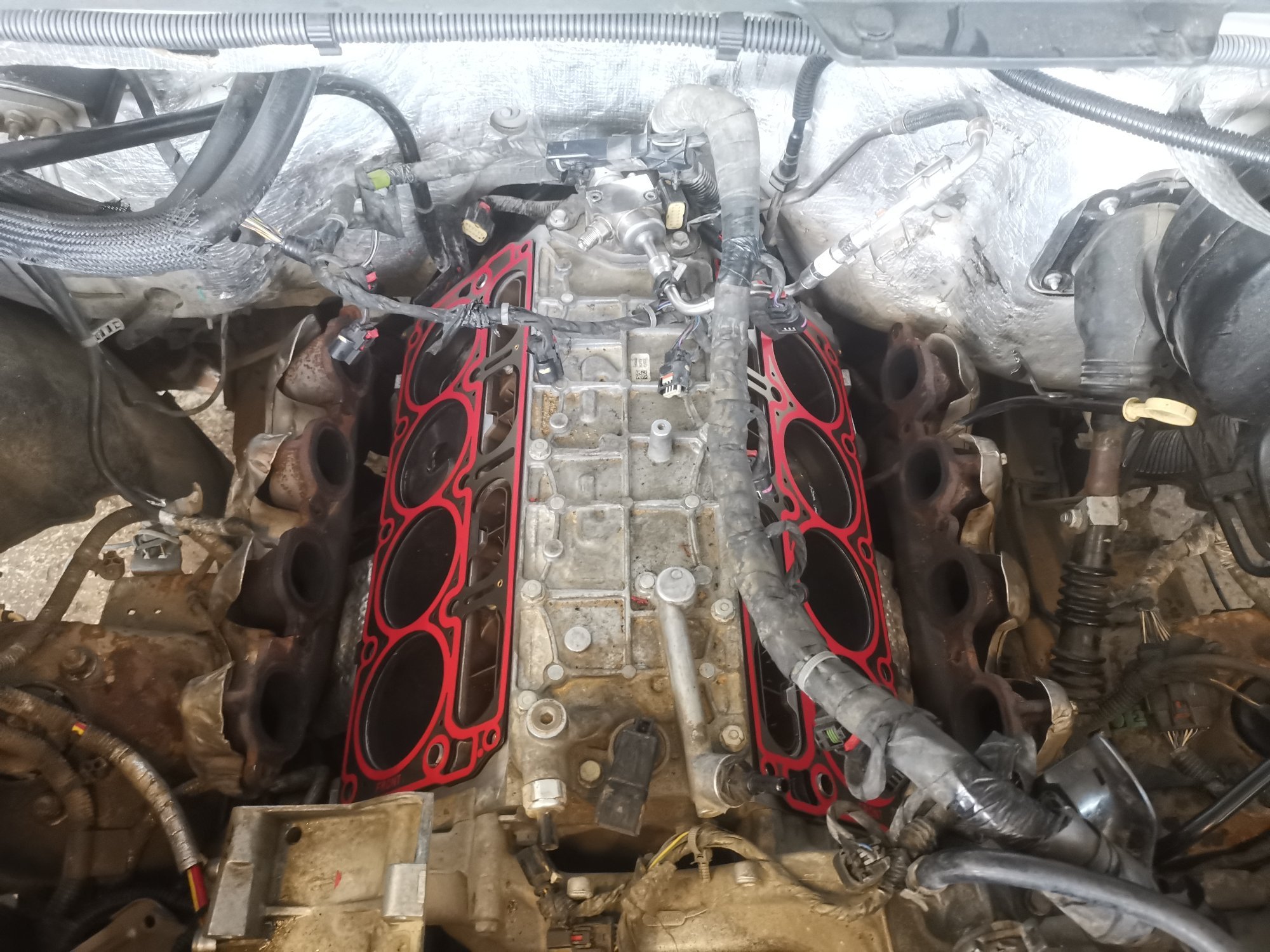

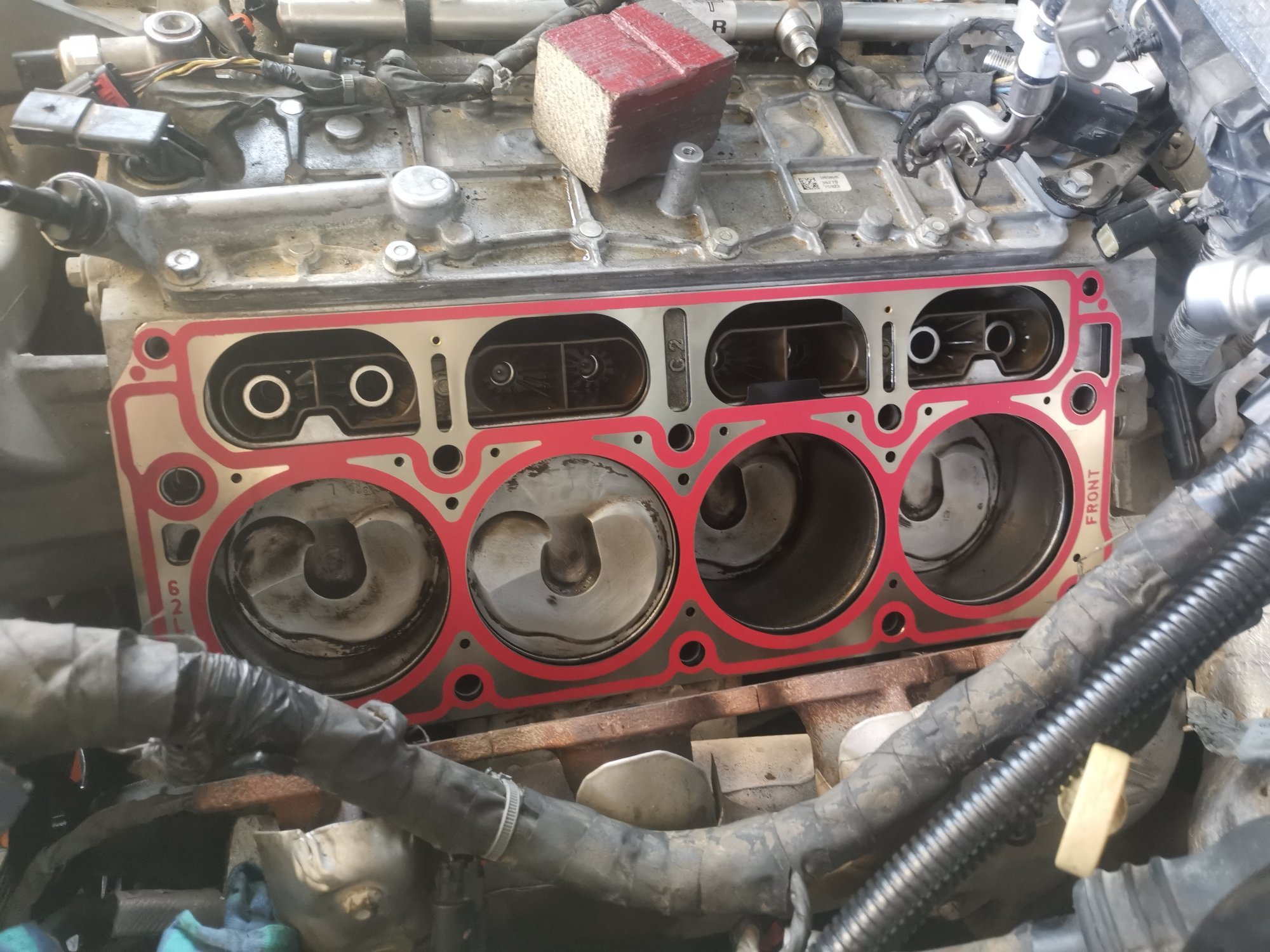

It's possible I've done that 😭 but not sure to have seen any side on the gaskets. Can you tel me if it seem right? I have a pic

I can see in the pic it’s backwards. It says “front” on the right side, facing the cab. The front of the engine is towards the grill. You have to turn the gasket 180 degrees, and flip it upside down. So where it says front will be towards the fans, and you won’t be able to see the word “front”. It’s blocking a coolant passage causing that symptom
Just realize it regarding the picture, don't how I've done a so stupid thing..
I'll change them and let you know. Thank you
You where right, I just changed the head gaskets (again...) and it works fine. Was really stupid but I've learn something. Thank you
