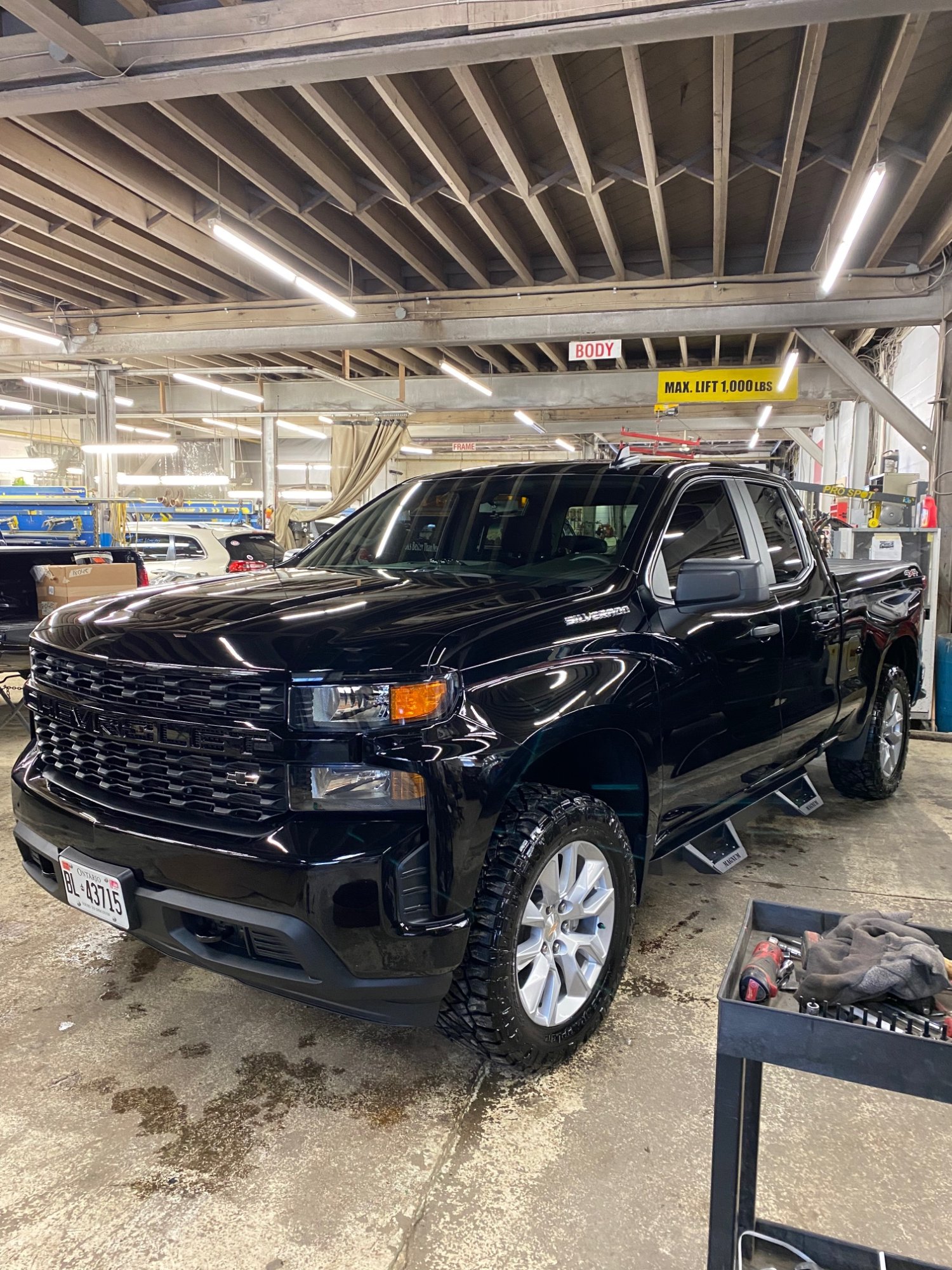

My 2021 Silverado Custom with the L82 and 6 speed has almost 14,000 miles on it. Had fluid and filter changed at 10,000 miles….trans always acts like it slips when shifting into 3rd gear under light to moderate throttle. More noticeable when cold in morning. Not an issue under wide open throttle. Are the torque converters bad in these??32D196F9-D550-4091-9F26-109C0C8CC74E.thumb.jpeg.0ed9baa2797831e2af0db4b9f9a455a1.jpeg

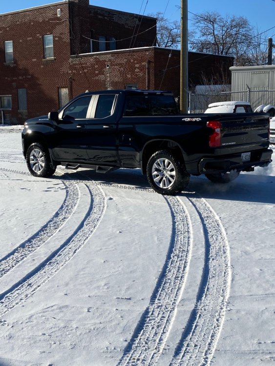

I will stay on it for sure. It’s an awesome truck! Just want it right so it lasts me. It’s not easy to keep it looking good up here, but I make sure it’s good! Anything you could suggest would be appreciated. Thank you!!13973409-3D02-48C5-A5B8-FC4FAFDAF112.thumb.jpeg.ac3665f2ae7917d8382539de0c7024c4.jpeg
