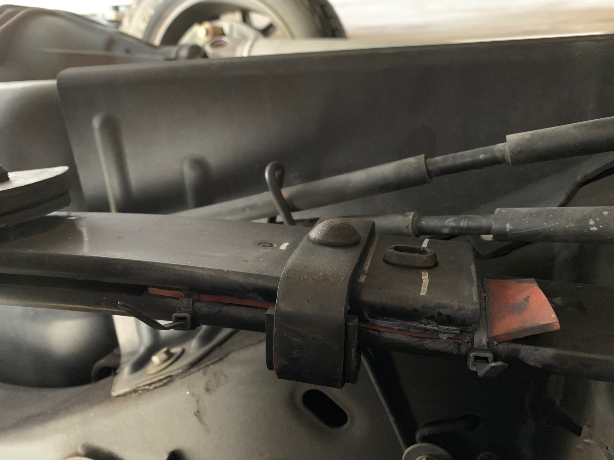

7 minutes ago, Domenic Ameruoso said:
Hi I know this post was years ago but I m having the same issue with my 2016 GMC Sierra 1500, I was wondering where did you put the rubber on the leaf spring to prevent the “pop” noise? TYIA
Hope these two pics help.
GAH! I don’t know why the pics are upside down.
