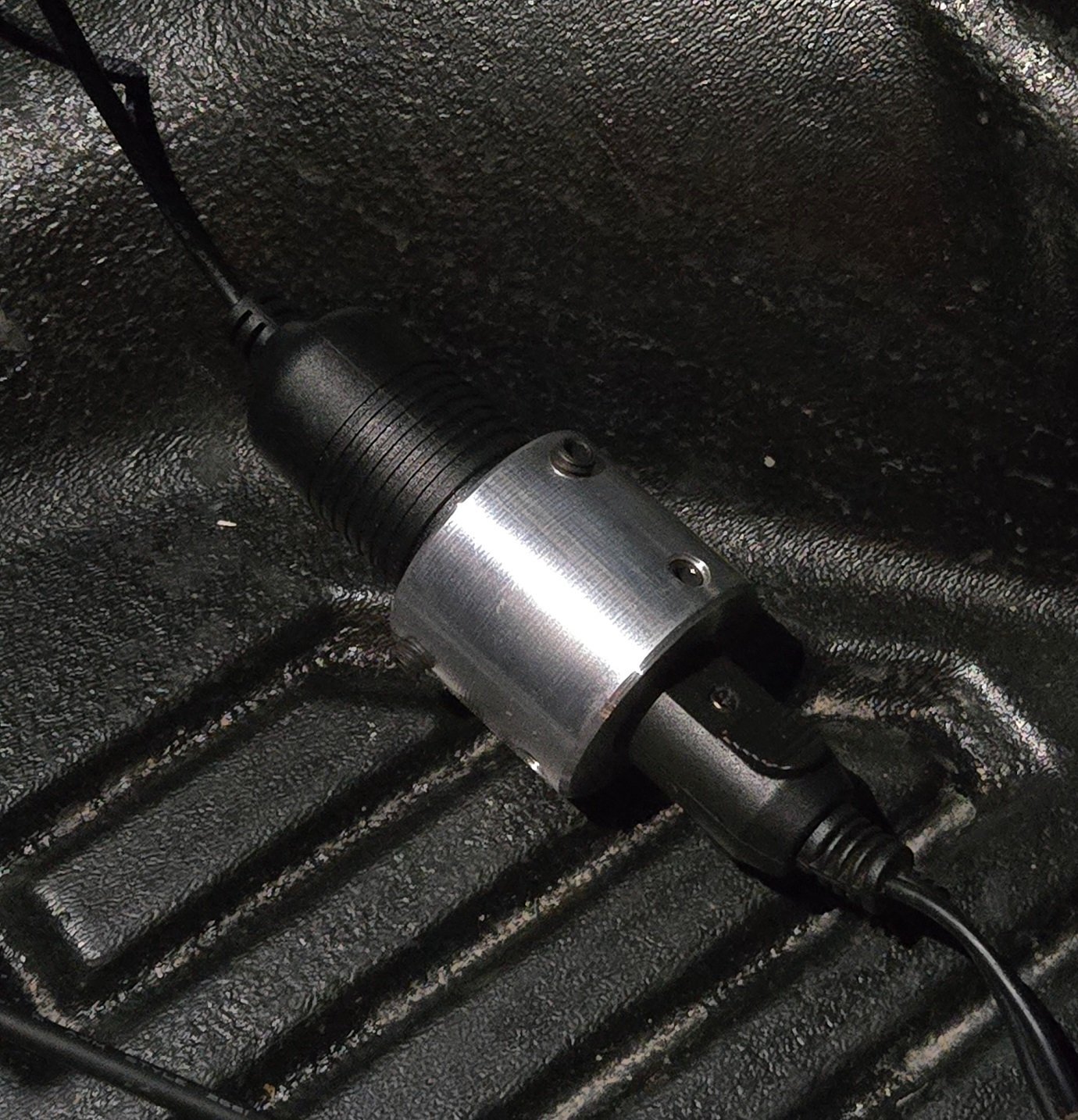

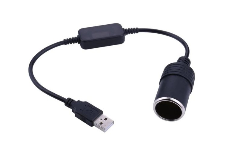

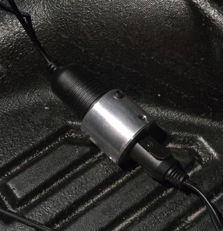

I picked up a 12V female to USB male adapter @ Auto Zone last fall. I had to machine a 'retainer' as the male plug from the GPS kept popping out of the adapter due to the spring pressure. No problems now.
This is what it looks like unpackaged:Screenshot_20250418_141619_Chrome.thumb.jpg.9eadef9d5fbb66e225e9ce6e055db3e7.jpg
