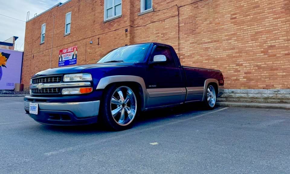

Hey all, I am at a loss. My Z71 4x4 is lowered on spindles with the torsion set fairly low and 22inch wheels and I keep wearing out idler arms. Like, every 2 months a new idler is needed. The symptoms are a death wobble at 60mph. New idler, it goes away. Comes back in 2 months. All front suspension is new from shocks and bushings, etc. Has anyone encountered this? Thx
If you want my opinion on it, it's those heavy wheels and tires you have.
Coming from my days working in a shop it really didn't matter what part was used sometimes. Customer vehicles that were lowered or lifted would wear the suspension out very quickly. Maybe not every 2 months but within 10-20k were we seeing parts start to show wear again.
The 2WD guys have less problems because they use a regular steering rack. Yours looks like a 4/6 drop and with driveline angles and heavy rims, I think that is why the front end is not happy.
That is just my best guess at what is happening. I'd raise the front up some or try wheels that don't weight 90lbs each.
