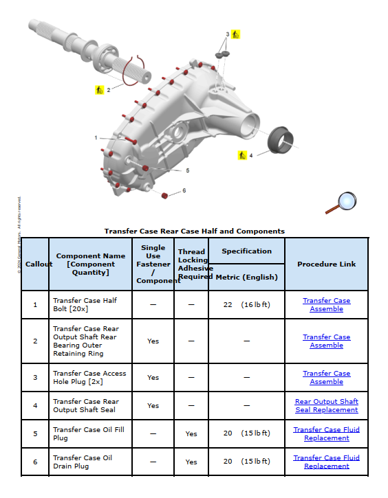

6 hours ago, john kari said:
I'm looking for the torque specs for the drain and fill plug for the transfer case. Thank you
8 hours ago, bruceb58 said:
Is that from "factory manuals.net"? I need to purchase one of these
Edited by AndrewF
Yes it is
