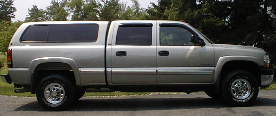

I have the fiberglass cap that was on my '00 1500 excab shortbed on my '01 2500HD crewcab. It fit's perfect.
