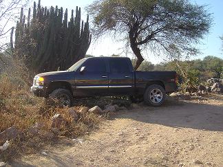

post-27160-1157739825.jpgi have a 04 gmc sierra, would the denali headlight bolt on, some mods, or not at all
i know i would need new lights
I have an 2006 sierra,and swapped the lights easy.
But i bought oem lights from the dealer pricy but i felt in the end it would be the simplest.
They came with everything i needed swicthed in the parking lot before i left.
Hope that helps
I bought a set of used OEM Denali headlights off of Ebay for my 2003 Sierra. They are almost a direct replacement for the stock headlights. They will bolt right in, but you will need another set of 9005 bulbs, because the Denali's use four 9005's instead of 2 9005's and 2 9006's.
