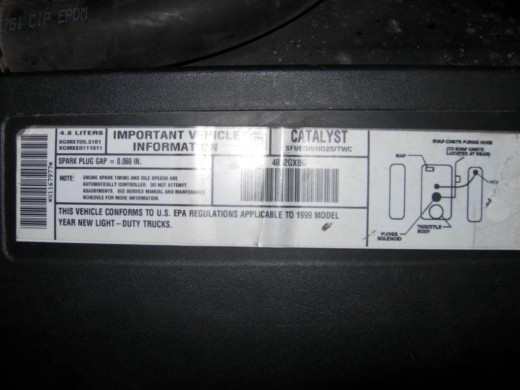

Look on the radiator shroud. It should say something like EVAP EMISSIONS REQ. Or RODUST FUEL SYTEM... etct etc. That will tell you which one you need.

yeah, i think that sticker is gone, ill go check in a sec.
