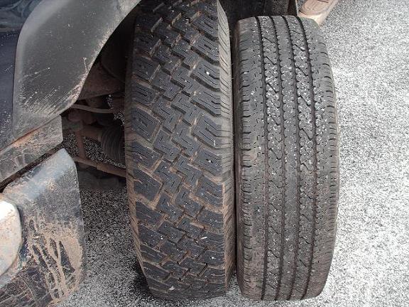

And a couple of comparrisons:
On the last one notice how the sidewall tapers in to the tread. the one on the right is a factory LT245/75R16 the left is the LT255/85R16 The LT245 is SLIGHTLY wider :lol:
The LT255/85R16 is also a load range D which, IMO offers a better ride than the load range E. By going to the bigger tire (even w/ it being LRD) it still has a higher weight rating than the factory tire.
My only gripe is there are very few tires to chose from (mostly commercial or very aggressive mud tires). They do ride slightly better than the LRE with a slight hum on the pavement. I would love to see BFG make this in the ATKO. That would have been my choice.
