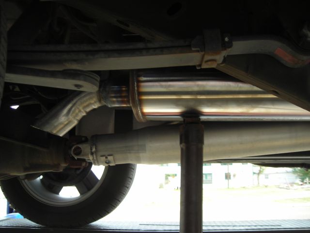

I just had mine done last Tuesday and the stock muffler is 2 ¾ but if you buy a 3” you will be ok mine was a Magnaflow 22” 3 in and 3 out in the center and it worked great .

I just had mine done last Tuesday and the stock muffler is 2 ¾ but if you buy a 3" you will be ok mine was a Magnaflow 22" 3 in and 3 out in the center and it worked great .
