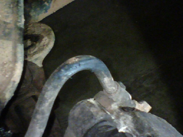

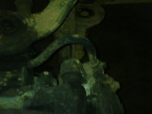

On a side note, I found something else that worries me. Something (the wheel) has been rubbing on a brake line, and is starting to wear it away! Sorry for the crappy pics, They're fom my phone.

From the pics the brak line looks like it is run correctly....dunno
