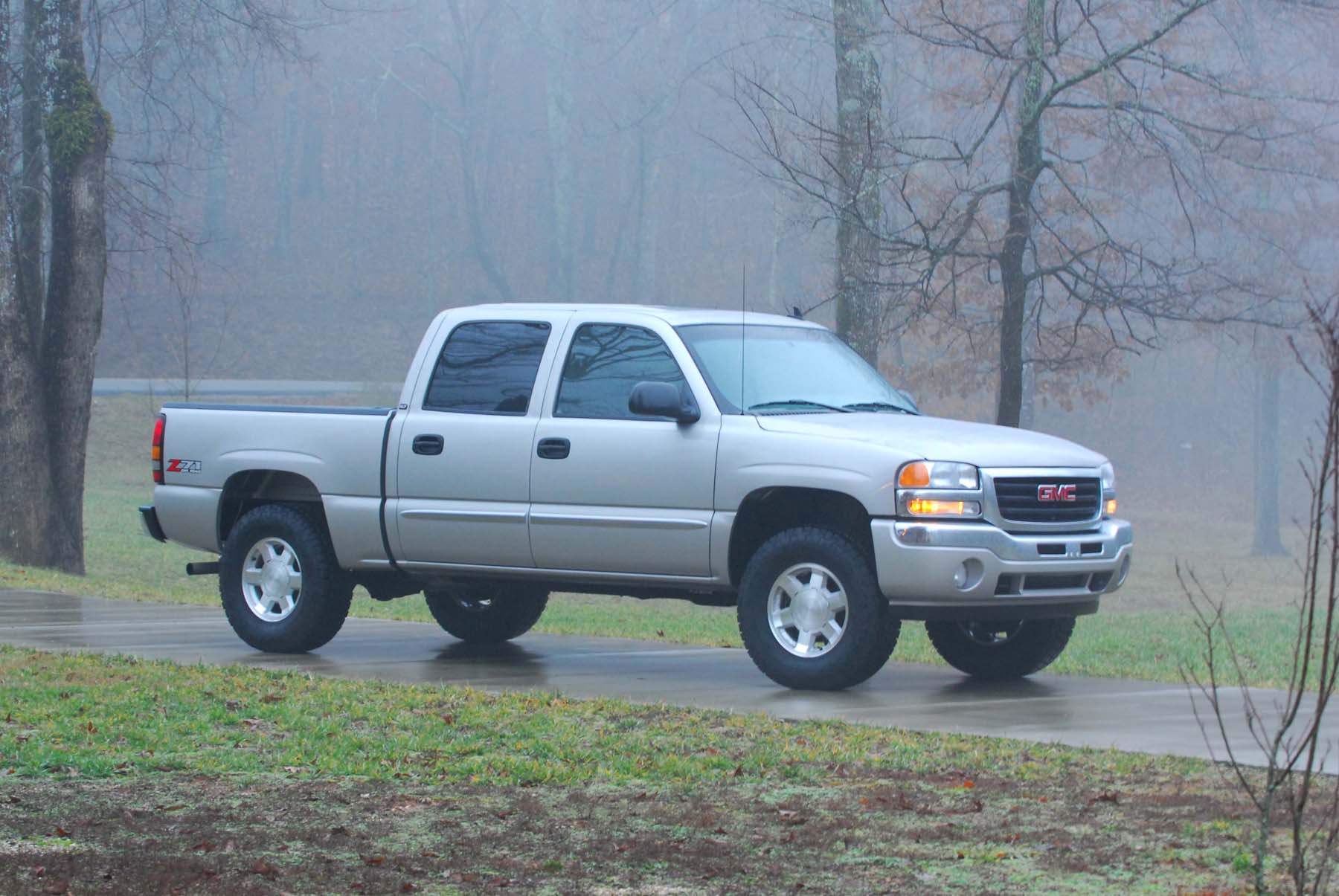

I can't answer all your questions but I just had the Truxxx 3"/1" Leveling/Lift kit installed yesterday on my 2006 Sierra 1500. It fit 295/70/17 Nittos with no rubbing at all...that is...normal street driving. I think it looks pretty good...MUCH better than the dragster look it had before. So far, the ride is still great..maybe just a tad stiffer but not much. As the days go on, I can give better info on how it rides, etc... Good luck on your research and I hope someone will give you the info you need. Here is a picture...

Nice looking truck. I'm planning on the same front lift. On the back, did you take out the existing blocks and replace them with the 1" blocks from the kit? I have a 1500 with the Z71 package, and already have blocks, but maybe the ones in the kit are higher.
Thanks! The kit comes with 3" blocks that replace the 2" factory blocks which results in a 1" lift. You can see the instructions and photos of what the kit includes at www.truxxx.com.

I appreciate you saying that, cause now I am going to go buy the 3" blocks and install them on my rear. I need just that 1" inch lift to make my truck finally sit perfect!

I have the same exact truck and color except being a 2007.. That is how I would like my truck to sit.. Would you be able to make life easier on meself and providing the part numbers for that exact one so I can go ahead and order.. That will make my truck look top notch..
The part # is 40435 and is for a 2006. I ordered it from FatBobsGarage.com for $275. The 2007 models are probably different so you need to chec out their site for your specific year model. Here is the link to the part on the Truxxx.com website. http://truxxx.com/chevrolet_products/404035.htm. Remember, this one included shock extension brackets as well...So...3 things: Keys, Shock extension brackets and 3" rear blocks.
