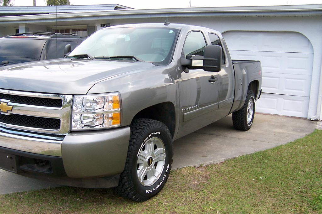

I put a Rough Country 2" leveling kit on (which is roughly 1.75" actual lift, give or take) and I'm fitting 285/65r18 (32.58x11.22) without rubbing at all, even when backing up...The only time I can see it rubbing is when I have the suspension flexing hard.
Yep, that's what my tires are also, and after removing the front mudflaps, they don't rub, but there is no extra room either. I had ordered 325/60R18's which are 33" dia x 13" wide and they didn't even come close to fitting without rubbing, they hit the metal fender lip behind the front tires near the bottom (behind where the mudflap was mounted).
I had considered trying to put on a size bigger, but didn't really want to gut out the wheel wells like I did my last truck.
