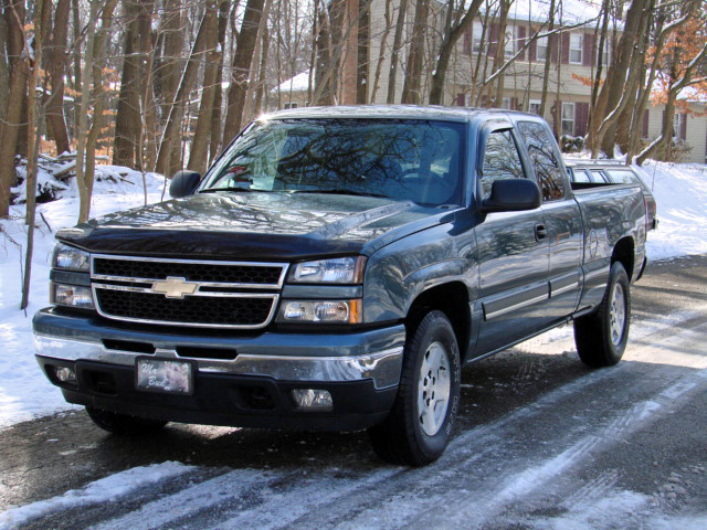

post-45534-1205874334_thumb.jpgpost-45534-1205874270_thumb.jpg I'm trying to decided on what new shocks I can put on my 2006 Silverado 1500 4wd. to "smooth" out the ride some. I'm considering Bilstein # BE5-6500-H0 & BE5-2905-H1. Or going with a Monroe Sensa-Track # 37152 & 37151. I previously test drove Z71 packages and they were not smooth enough for my back, so I went with a 4X4 pkg without the Z71 Now it too, is causing me some lower back problems. I get a numb right foot when driving. I guess I screwed up getting the Z85 trailer pkg. Damn nice truck I hate to have to get ride if it cause of my back.
I could really use some insight here on helping choose which shock would be better choice. Also are the Bilstein's I mention above... are they the OEM for the Z71 pkg? I also cannot find what the OEM is on the Silverado with a Z82 and Z85 pkg I have now. I can't find a web sight that gives the actual part numbers. Help........and yes. I'm going to treatment for my back :jester:
