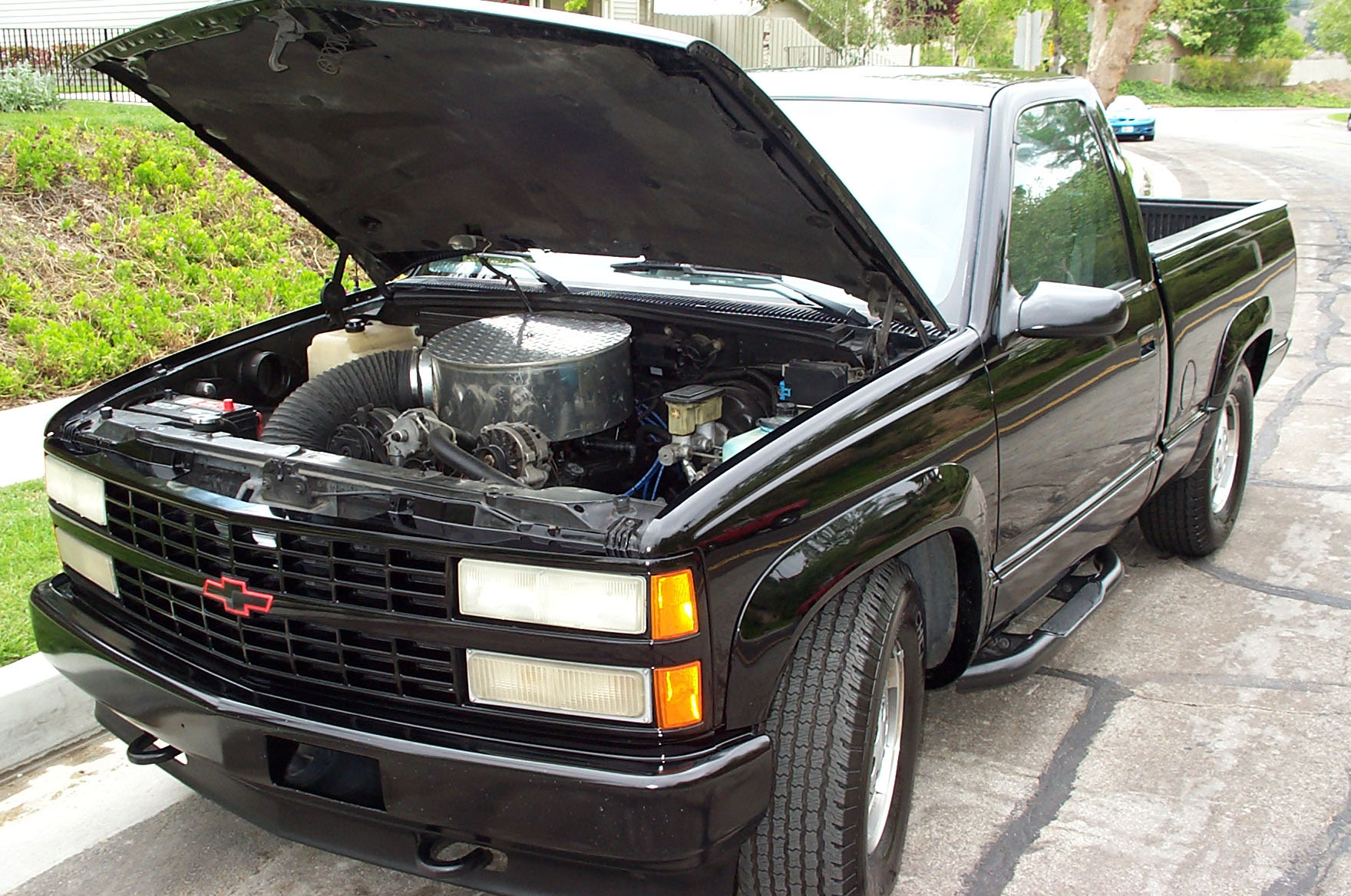

Thanks guys, yea, it still draws looks. I'll throw up an under the hood pic while I wait for an answer.
You did a phenomenal job. :rolleyes:

Hey Mike, thats a ram air, see the square hole cut into the bumper?
