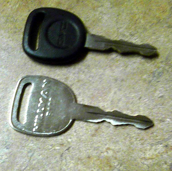

Ok...I'm getting mixed answers here, so I guess I'm looking for a consensus. My 2002 Sierra SLE did not have a "chipped" key, so an ACE Hardware flat copy will cause me no problems when used in the ignition. Correct?

As long as they use the correct blank and cut it correctly no,It will cause you no problems.
It's only $26.03 at gmpartsdirect.com although I'm not sure if a dealer has to program the key or if you can do it yourself.
A dealer does not have to program it,You can program it yourself.....
With a previously learned master key, turn ON the ignition, with the engine OFF.
Turn OFF the ignition and remove the key.
Within 10 seconds of turning OFF the ignition, insert the key to be learned and turn ON the ignition. The vehicle has now learned the new key.
This is the correct answer - it's in your owners manual & this is how I programmed the 3rd key into my '08.
Your replacement key should be stamped with a "+" inside a circle (same as the head stamp on NATO small arms ammunition) - this is the correct transponder key.
i just looked at my work truck an it has the "+" so i guess its chipped. an 09 silverado 2500 crew ls 6.0
Thanks MS3DALE you just saved me some $$$... I called the dealership a replacement key is $35 then $35 to get it cut and $48 to program it. I would have paid over $100 for a new key, instead i bought an OEM key with chip on ebay for $12.50 got it cut at a local hardware store for $1.75 and programmed it myself thanks to you for free!!!!
TOTAL COST $14.25 !!!!
