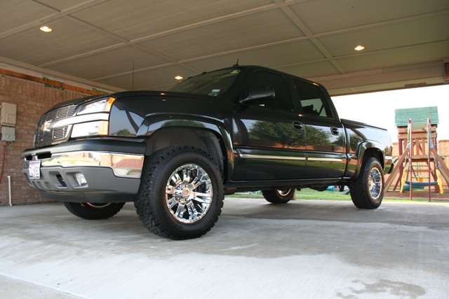

Here is a pic of mine after the lift. I haven't added the block to the rear yet. I'll probably do that in the next few weeks.
wow, that looks really nice.
Alan300, truck looks sweet. Is it truely level without the block in the rear? My truck does not seem to sit down too much in the front espically compared to the 07-08's. Those wheels are sweet. What size?

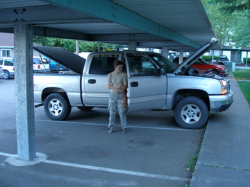

I Put ProComp torsion keys in my truck, which is the same as yours, they lifted it almost 2.5 inches in the front and the add a leaf should lift the rear an inch and a half. The downside is the torsion keys make it ride really stiff and you need to get an alignment. This is the only pic I have and that is not me in the picture. post-36895-1213643063_thumb.jpg
Stiff ride huh? Not good. I know it is a truck but I love the nice ride! Im having other issues with it so I might kick it sometime soon.

It's pretty close to level, the front is probably a tad higher but nearly unnoticeable. Although, i'll probably add the block soon anyway. The wheels are ProComp 18". I went with 1" bigger than the stock wheels just for the heck of it.
Does it affect the ride. It wouldn't have if I would have not turn the torsion bolts more than required. But, I bought 33" tires so a few extra turns were required to keep from rubbing. If you went with 32 or 31s, you could probably get away with not lifting and having the exact same ride.
