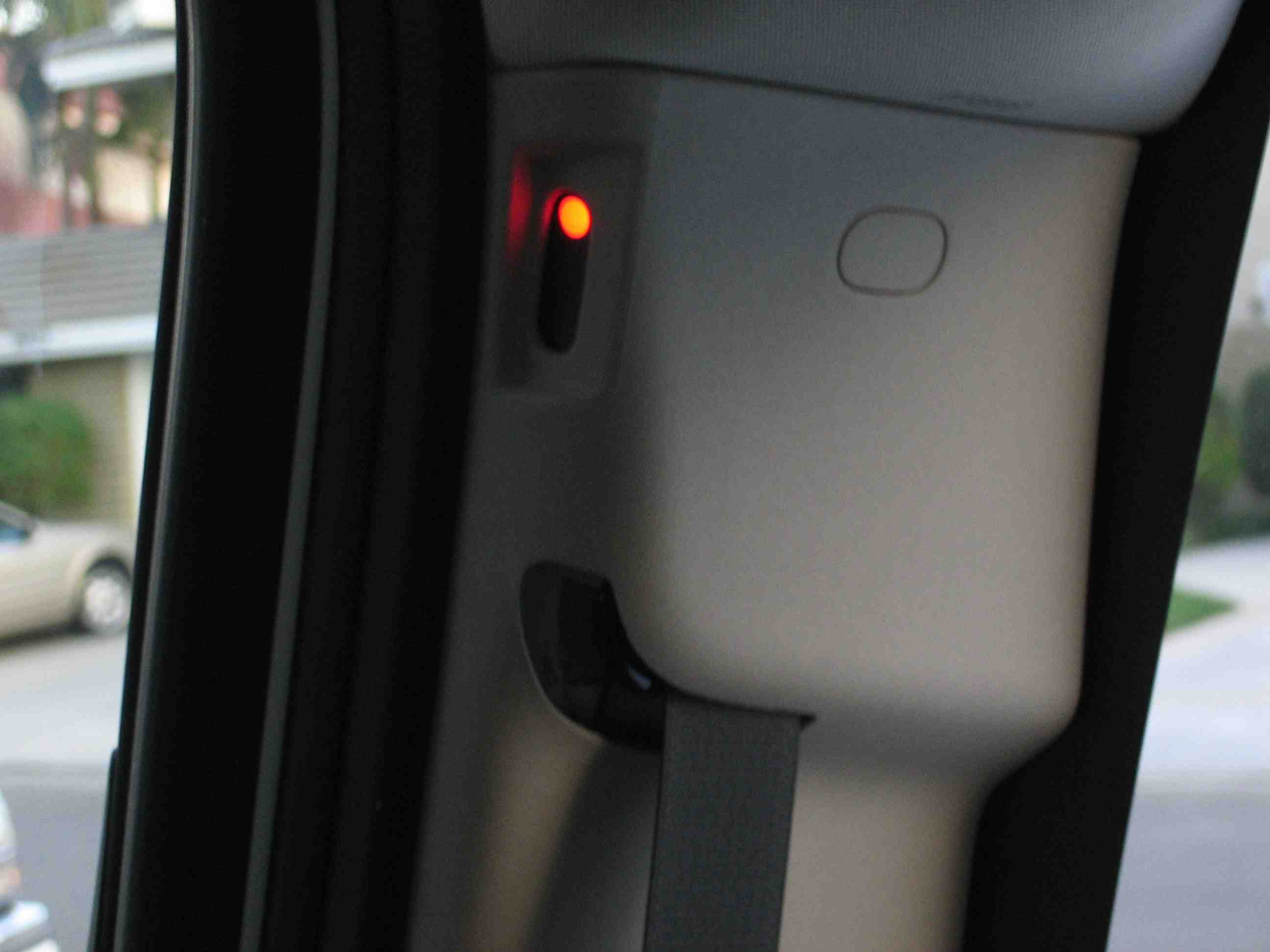

There are lots of aftermarket systems available for just about any vehicle these days. Go that route. Some of them are as simple as changing your license plate frame. The better ones have multiple sensors. The OEM one has lights integrated into the C pillar along with audible tones coming through the speakers. Too much work.

That is until a read a review on another board... Seems like the perfect product but the "steady tone" distance is 3 feet? That's fine for the "hey, did my kid leave his bike back there" use, but if my wife can't tell she's 3' from an object with my truck, she'd better not be driving it! I was thinking more like "Ok, I'm within 1' while back parking... I'd better take is slow!
Like said above i would get the rear camera. The parking assist is garbage....the thing beeps way too late. I can back up close to a wall and wait about three seconds and then it will go off.
