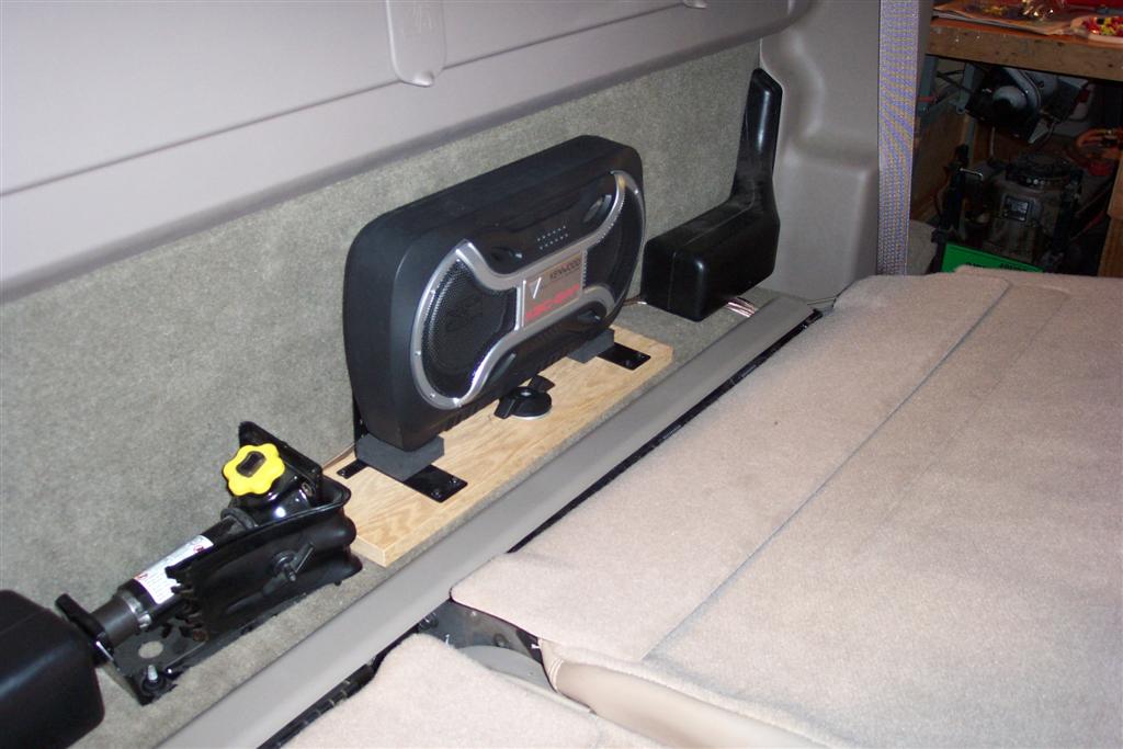

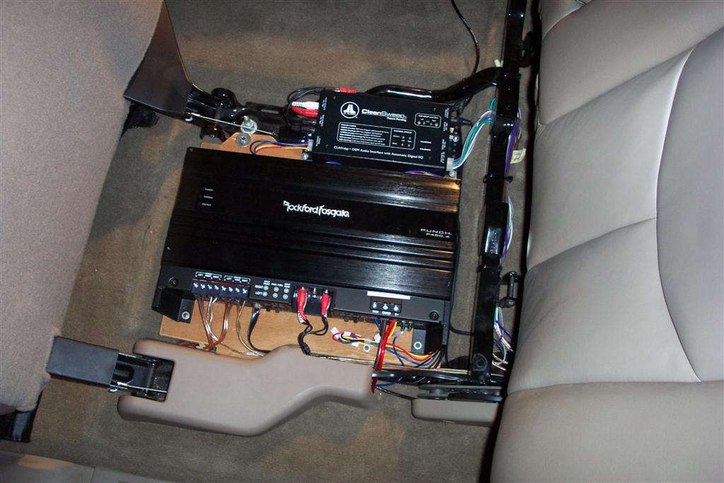

I have a very similar setup in my 08 and did a lot of research. Here's what I found. First off, here's what I have.
OEM Nav head unit
Stock bose amp (have to keep it i you want the head unit)
Alpine 4x100 and alpine 1x350
Infinity kappas in rear, components in front
JL Stealthbox
JL Cleansweep
JL Summing unit (Can't remember model)
I left the center channel as is still powered by bose. The sub output is definitely low frequency and it gets less output as you turn up the volume. I THINK the doors are tuned as well. As for the rears pillars, I would think they would be as they are really only tweeters. If you want to keep head unit balance and fade controls, I think you need to sum at least the sub and four doors. I think it would sound good if you could get some 4x6 or similar for the very back and put a little power to them. You could drive them through the spares in your amp. I'm not sure how much room there is back there. If you don't care about controlling that channel, you could drive them off the same summed channels as the doors. If you want to keep individual control, I think you need 7 summed outputs AND inputs from the amp. Mine are still powered by the bose amp but I can barely notice them not that I have good power going everywhere else. I chose to forsake the 5.1 and any bose "features" and basically drive the four doors and sub. Also, the infinity tweeter fits in the stock a-pillar location with minor modifications and remains behind the cover for stealth.
Make sure you have a wiring diagram as there are many differences between models and model years. It took me a good while to figure out all the wiring on my setup.

A couple of the nice things about the HD600's is that with just two I can power all the channels and they are low profile so they will both fit under the second row bench (the bench works better with car seats and little kids). A nice thing about the 3Sixty is that it will also do the channel summing without needing a separate unit (I was looking at the Cleansweep units initially). I any dealer actually had a Tahoe around here I'd go and poke around to see what good locations would be for speakers in the rear.
What do you think of the bass response from your Stealthbox?

The stealthbox is good to very good but not excellent. Way better than stock but not huge thumping. Nice tight snappy drums but not booming which I don't really care for anyhow. The sub should compliment the overall sound, not dominate it. Besides, I hate vibrating license plates :D For the money of the stealthbox, I think you could build better particularly if you went with a bigger box in a diufferent location. But for plug and play it worked very well and I had no fitment issues whatsoever. I had an 01 Tahoe and I replaced the 8" sub and it was better than stock but did not compare to the stealthbox. Overall I am happy with it but I think it is slightly overpriced.
My amps are under the second row tilt up seats. Tight fit.
