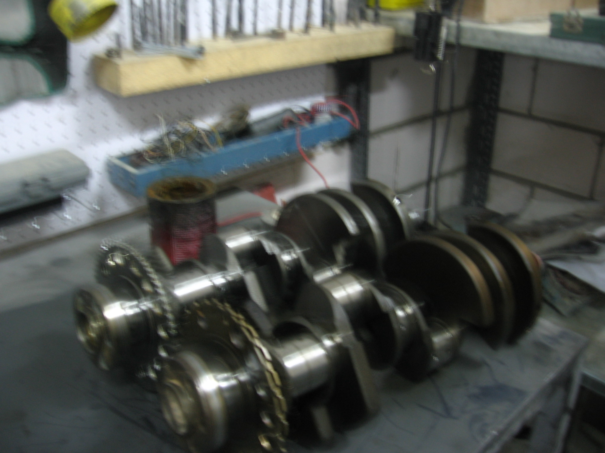

u can see the differance. the old crank and new one
the new crankshaft is ready
that block can handle a lot more mods...
