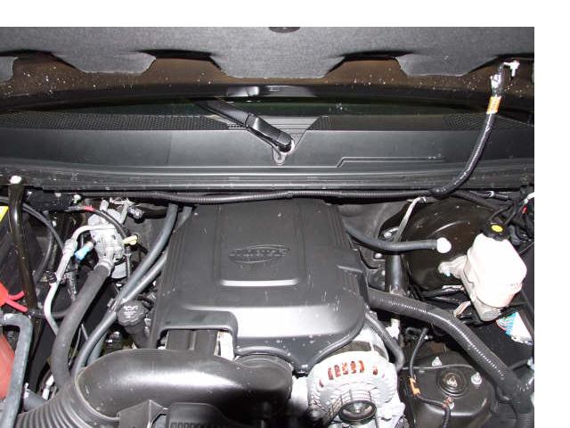

I'm trying to figure out how best to lift the new Denali I bought in August when I was home in the states. I thought it might have autoride which would have vastly complicated matters. However, the autoride shock has a cable coming out of the top, correct?
I had my wife snap a couple pics of the underhood area and from them, and looking at the strut area, I'm not seeing an electrical cable coming out of the top of the strut. Since I don't know exactly what the autoride appratus looks like, can someone with autoride look at this pic and confirm or deny if this Denali has the autoride strut???
Someone else can verify this, but I think (man, that's dangerous) that the YUKON Denalis have Auto-Ride, but the SIERRA Denalis do not...
For what it's worth, If you go to http://www.gmc.com/denali, the chassis packages are as follows:
Yukon Denali - Suspension Package, , Autoride, bi-state variable shock dampening and rear air-assisted load-leveling, includes (G69) automatic air level control (Z55)
Sierra Denali - Suspension Package, High-Performance, includes 36mm front stabilizer bar (Z60)
Therefore, one could ASSUME that you do not have the dreaded Autoride feature.

Great job bro. Good correlation!
I did look at that and even after reading it several times (High performance suspension) and not seeing the autoride mentioned anywhere, I somehow thought GM snuck in the A/R feature somewhere.
I tend to agree, I do not see evidence of autoride on Sierra Denali trucks.
That opens the door to the BDS type suspensions and lifted Denalis (and Escalades) with only the need for a double cardan driveshaft to make it all work.
Just re-read the GMC website and compared the Yukon and the Sierra.
The Yukon Denali has both Autoride, and Autotrac
The Sierra Denali has neither Autoride or Autotrac (Yippee!!!!!!!)
