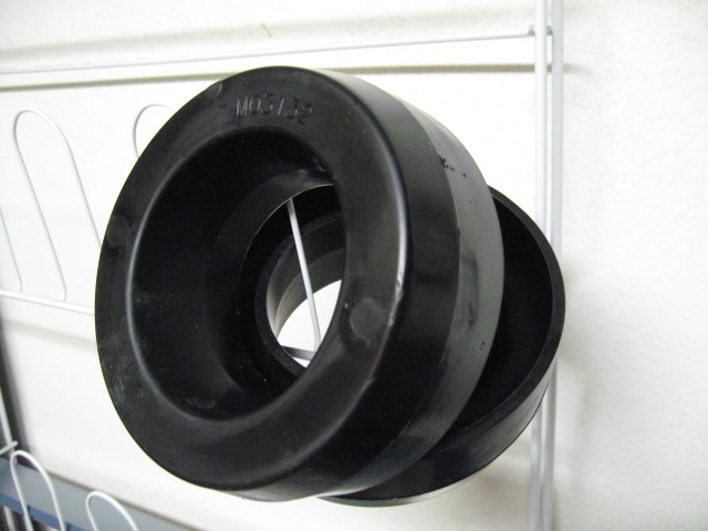

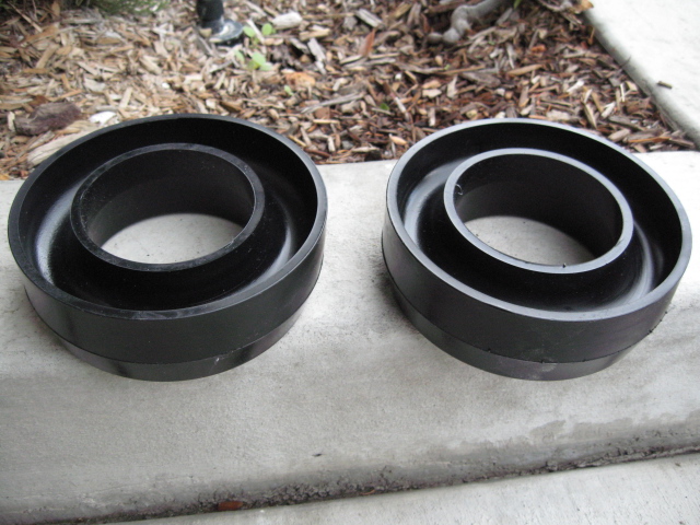

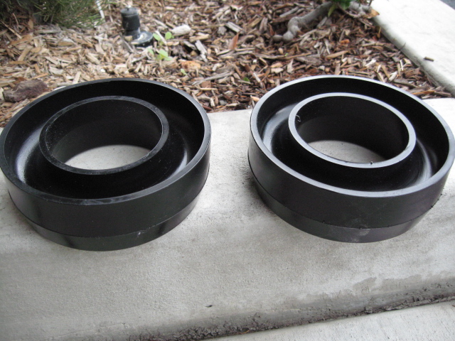

Selling them never crossed my mind, I guess I can make up some of my loss. I just went to my garage to snap some pictures. They are 1.5" spacers that will give you an end result of 2" on your truck. If you want them, I'll ship them to you for $60 even.
Sure, I can do that. I'll send you a PM in a bit. Do you happen to have any pics of your truck with the coil spacers installed? Not sure how 1.5 spacers will give me 2" raise?
It's because of where the fulcrum point is, it's a ratio/leverage thing. It'll give you the 2" of extra height.

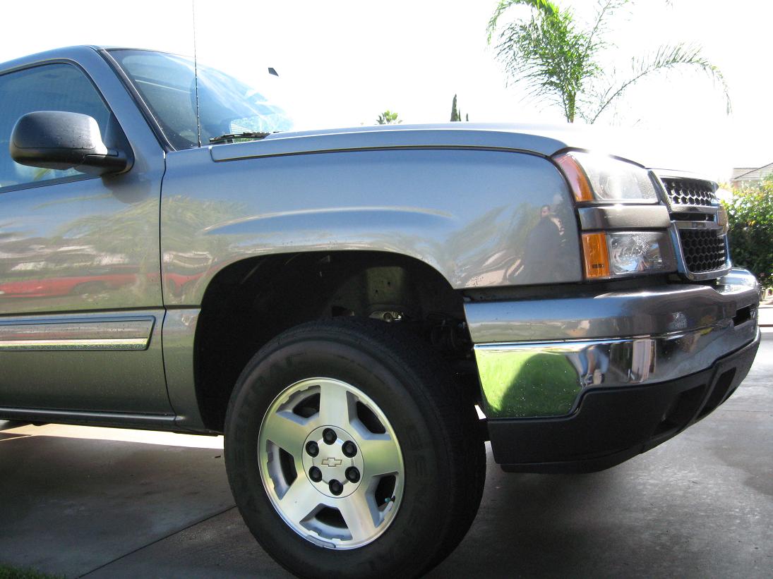

I don't have pictures of when the spacers were on. However I do have current pictures of the Spindles. The spacers will be a little lower than the spindles.
This is the only before picture I can find:
and these pictures are with the 3.5" Spindles in front and 1" Blocks in the rear.
That isn't as high as I was expecting it to be with the 3" lift. Just curious, where did you get the spindles at? Also, are the spacers supposed to go on the top or bottom of the spring? If top, that means I'll have to remove the lower control from the spindle and in that case, I would probably just rather do a spindle life. You said you will be able to run 33's with your lift now, correct? I'm starting to like that lift more and more now, lol.
These coil spacers went on the top of the spring. I purchased and installed my spindles at a local off road place. You are going to also want 1" blocks in the back to keep the truck level. As for tires, 33" will fit easily.
Spindles are worth the extra money and once I get 33's on there, my truck will be exactly where I want it.
Looking back, it kind of disgusts me how low stock actually was.
