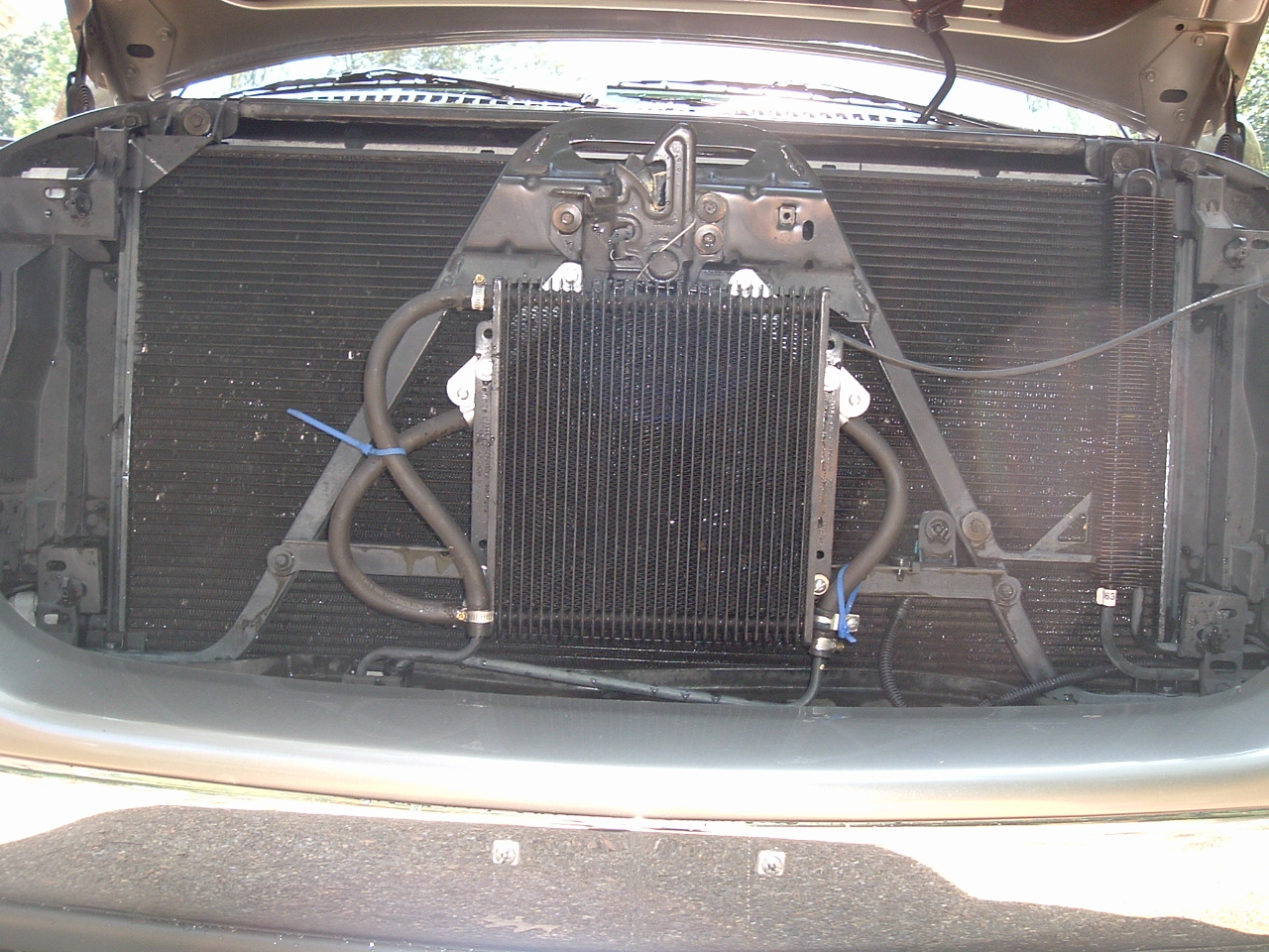

Tage, my truck is an 02 Yuk Xl and I tow a 6500 lb camper in the Mississippi heat in the summer. I upgraded my OE trans cooler to one of the same stacked plate design but about twice as large. My cooler is a CARQUEST Premium model by Hayden and is 11 x 11 x 3/4 thick. You want to stick with the 3/4" model and not the thicke 1.5 model as the thinner models offer better surface to air heat transfer. I would not recommend bypassing the radiator for any reason. No OE MFG I know of bypasses the radiator and the aftermarket companies I am familiar with agree.
I monitor my trans temps with an Aeroforce Scan Gauge and run temps in the low to mid 160 range on a 95+ degree day towing my camper. My engine temps run right at 195 but will hit 200 on occasion.
Here is a shot of mine installed. I have about 7 or 8 good pics I can send you via e mail if that would help you.
