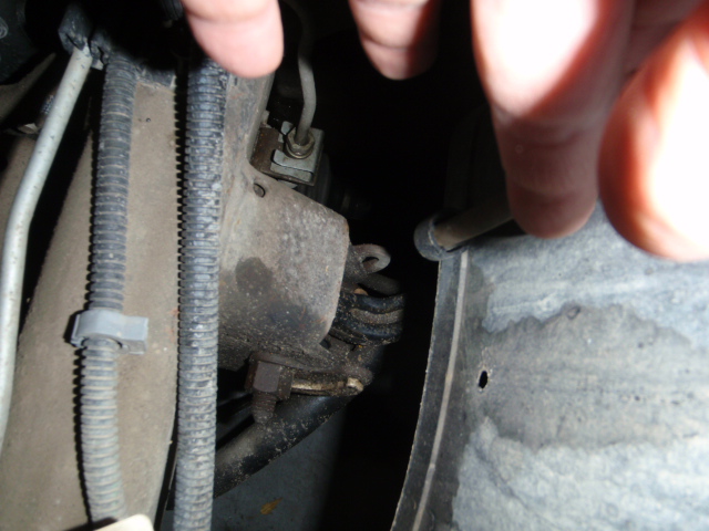

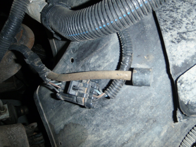

i had the same problem with my 04' Z71, the solution I found was the diff vent pipe cap was hanging upside down and plugged full of mud. Removed the cap cleaned it and put it up under the wiring harness, no more axle seal leak :)
as found, sorry crappy pic
put under harness
put under harness
I did the same exact thing but found no mud,it was hanging down though,took the cap off blew thru the hose and tucked it inder wire harness as you did.Seal is still leaking quite a while after i did that.But thanks for the idea and the great pics! I guess im leaning towards another seal.Maybe a different brand other than GM would ride in a different spot.
