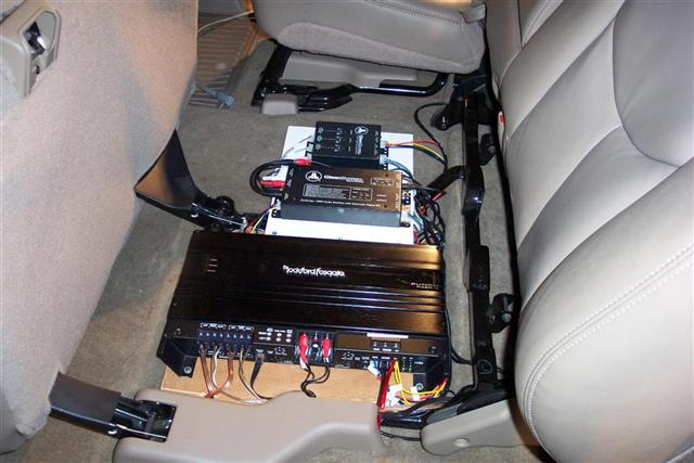

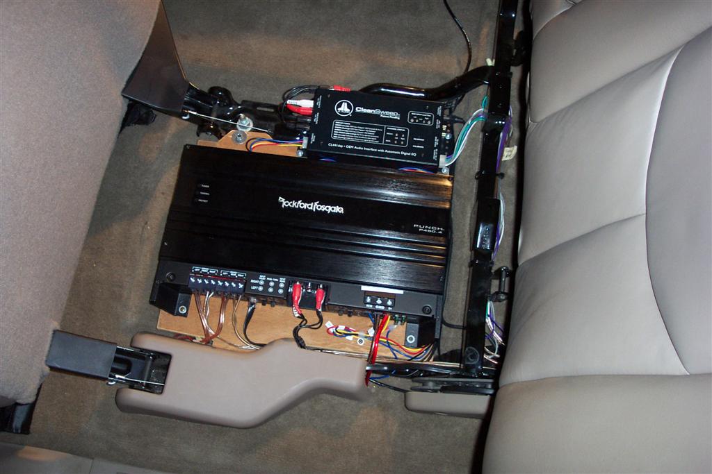

Let me explain the whole setup...it's a long story, but I'll try to make it short.

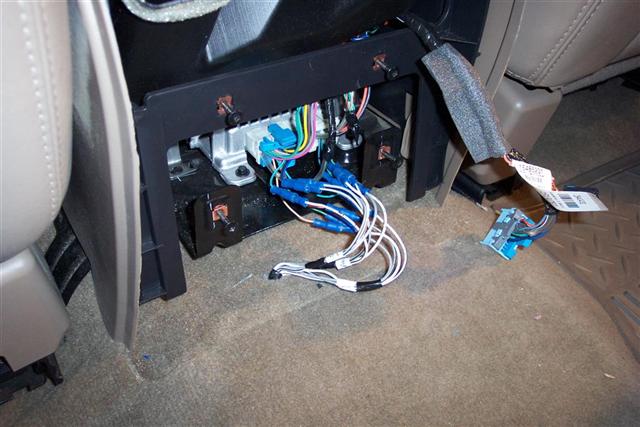

  1. Wanted to add Auxiliary input to the stereo system, so I purchased a Soundgate AUXGMV3 auxiliary input converter. Simply plugs in to the factory harness behind the HU and I mounted the unit itself in the dash behind the glove box. Worked great...but the audio signal was much lower and I had to turn the volume on the HU up almost all the way for medium volume at the speakers.
  2. To cure the auxiliaray input volume problem, I purchased a PIE LD-1 adjustable line driver with subsonic filter. This is a driver/pre-amp that boosts the RCA level signal from the auxiliary input. It has independent channel volume adjustment and works great. Buuuttt, the stereo still doesn't have good base and sound could be better quality at high volume. I don't need the base to slam my head into the windshield, but I do like a good solid base that I can feel.
  3. Still not satisfied, so I replaced the door speakers with new Kenwood 2-way speakers; KFC-X1700 6¾". Yes - they fit in both the front and rear doors (I have the crew cab pickup). I had to trim a little on the door panel (on the inside behind the speaker grill) but it is not visible and the original speakers could be re-installed and nobody would know it - except for the sound!
  4. Besides the door speakers, I added a Kenwood powered woofer; KSC-SW1. I tapped into the existing speaker wires for the signal to use.
  5. This made a huge difference in sound, but I still didn't have the volume I wanted. So I decided to add a JL Audio CleanSweep CL441dsp and a Rockford Fosgate P4504 amplifier (4 channel - 450 watts max power output). The CleanSweep CL441dsp takes the signal from the HU - "cleans" it and sends it out to an amplifier. It actually does a lot more than that according to JL Audio, but I don't have all night to explain! I hooked it all up with much anticipation....and it didn't work at all.....AARRGGHHH!!! Found out that the signal that comes from the HU on a Bose system is not compatable with the CleanSweep and I needed to add one more piece to the system. I had to buy a "summing device" - a JL Audio CL-SSI. I was a bit ticked off that no where in any of the CleanSweep CL441dsp do they mention "oh..by the way...you will also need to buy the CL-SSI if you are using this with a Bose sound system" ARRRGGHHH!!!! One other note...when I hooked up the CleanSweep CL441dsp, I disconnected the signal from continuing on to the amplifier and sub woofer in the console.
  6. After MANY hours of frustration and buying way more than I entended, I finally do have a great sounding system. If I knew then what I know now...I would have yanked the HU and avoided the JL components. Also, the powered woofer is OK...but I have heard better. It's only a 6½" woofer, so I guess I shouldn't expect much more.
  7. Now if I could only get the amp to stay on the same as the HU.....sigghhhh......
I've attached some pictures to show the final system and if you want more pic's...let me know. I took a lot of pictures documenting the installation of everything. I also was able to have a friend of a friend get me a PDF file of the stereo schematics for my truck - which was the final ticket to help me decipher the mess of wiring.
WOW. Seems like getting an aftermarket HU may have been a better route. That's alot of "points of failure" within the system. Hopefully, you won't have any problems. But, at least you got it squared away, which was the main goal, right? :thumbs:
