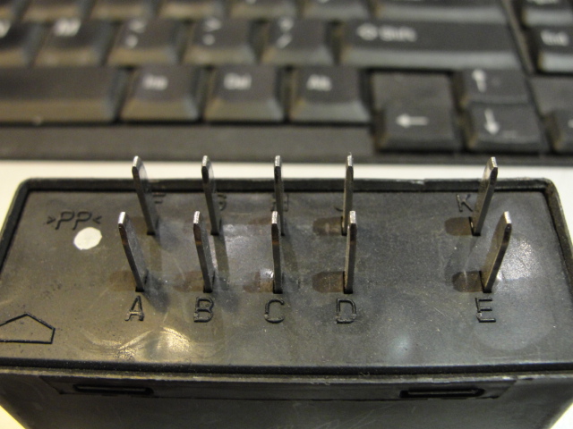

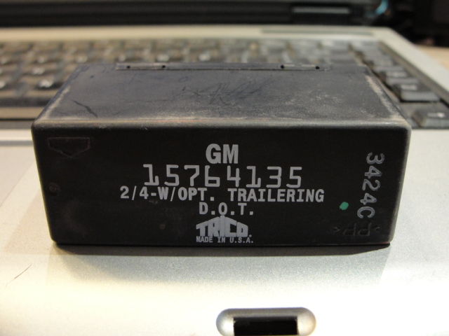

I just had this exact same problem with my '05 Sierra 2500HD myself and it was the LCM (Light Control Module aka Turn Signal/Hazard Flasher Module). To get to it you have to remove the beauty panel below the steering wheel. Once you remove the panel you will see the module directly behind the fuse box at the bottom of the box (the fuse box faces towards the drivers door, and the LCM faces towards the steering column).
To remove it pull it straight out towards the steering column (it is black in color, has 10 blades, slides in and out like a fuse would and the end you can see measures 1" x 2-3/4").
Part #'s:
GM OEM: 15764135 (about $90 from a dealer)
Napa Auto Parts (OEM Replacement): LM-455 ($32.99)
Napa Auto Parts (LED Compatible): LM-487 ($76.99)

Thanks to the internet and this site I saved my sanity. I ask myself why I don't go to the net first but I guesstorture is my thing. I have a bunch of GMC DURAMAX DIESEL trucks through our business but never seen a problem witha left trailer brake light not working. I got really tired of everyone telling me my left brake light wasn't working (never the less the legal implications) It is the plug in module right behind the under dash fuse block and was an easy fix (this after I chased all the wiring with a test light through the whole truck and found I had nothing all the way to the front) I have a little bit of an advantage in owning a recycling yard and now I carry a spare in the centre console!!! 15764135 2/4-w/opt trailering .

Ok heres what i found.
The part shown earlier is correct #15764135 and this is the correct gm number. It has been subed to 10383321.
If you are looking for this part from gm expect about 90-115 dollars and you should quote the part # because they dont seem to know where to find it. I think the reason is the discription name varries by manyfacturer.
I located some aftermarket ones at misc prices. Best was $47.00 at carquest up to $74.00 at benson. All places could not find unless i quoted the part number for cross reference.
I purchased mine from an auto wrecker in my area for $25.00 cash. Was asking 40 but when i told him the new aftermarket was 47.00, he dropped to 25.
The unit i retrieved from the wreckers had the new part # on it and from what i understand, the newer one is LED compatable.
Now you need to remove the decorative plastic over the guages, then there are 2 screws at the bottom of the plastic pannel below the column to remove, the top of this pannel is snapped in place with clips.
after removing pannel, look on the back side of the fusebox located on the side of the dash below the headlanp switch.
it will be vertically mounted. because there are 10 pins on it you will have to pull and wiggle it slowly to remove it. Keep attention to the direction the pinsare when you remove it because its not ambidextrious. install replacement in reverse order.

I also had this problem with my left brake light not working on my boat trailer when hooked up to my 2003 suburban 2500 HD.I removed the light control module behind the dashboard fusebox and found that the armature on one of the relay solenoids was binding on the plastic case that encases the solenoid. I freed up the armature and the problem was solved. Part # 15764135
