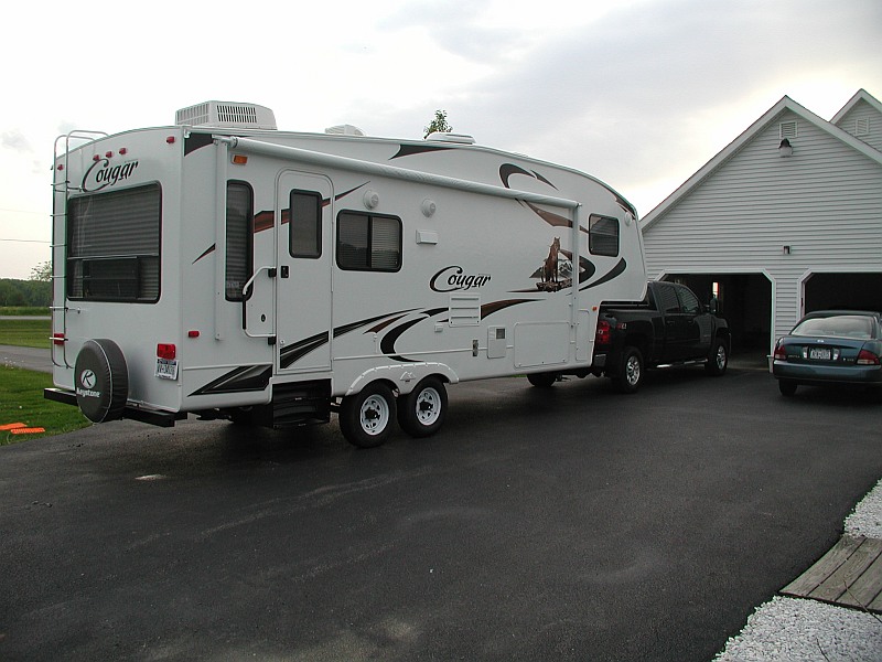

Well... just put a deposit down on the 5th wheel and scheduled the hitch install. I decided to splurge and get the PullRite SuperGlide automatic sliding hitch. Hey, I'm getting old & lazy. :thumbs:
Well... just put a deposit down on the 5th wheel and scheduled the hitch install. I decided to splurge and get the PullRite SuperGlide automatic sliding hitch. Hey, I'm getting old & lazy. :D
OK, so what 5th wheel did you buy?
2010 Keystone Cougar 276RLS
