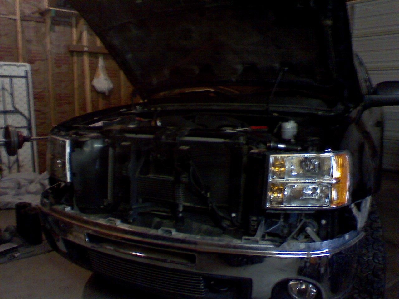

you have to remove the peice between the grille and chrome of the bumper. there are 2 screws on each side (the very edge in the wheel well area). the rest just snaps in or out of place around the corner and across the middle area. if you can, try to use something really thin to kind of push down on the clip peice while pulling out. something thiner than a butter knife.
sorry for the bad pic, its the only one i took.
