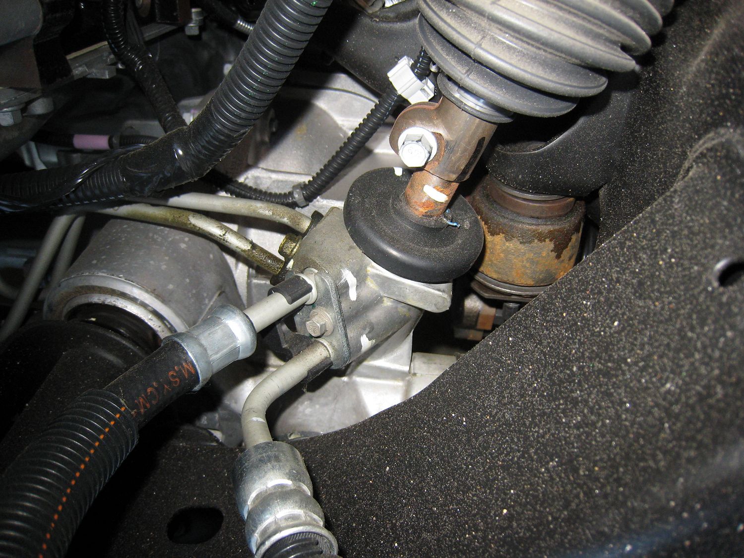

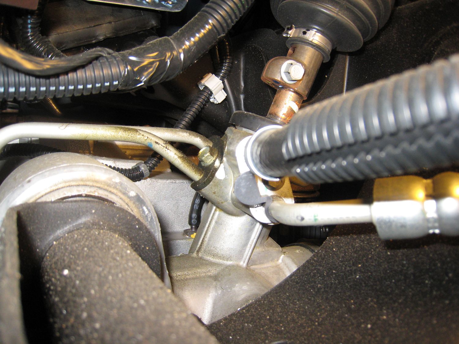

Any of you guys STILL think I should take this in for warranty work instead of taking the 10 minutes to have a look? I can grab those two lines with minimal force and they move.
I must admit...that little plastic spash guard was soooooooooooo difficult to remove :lol:
So the lines are loose? What's involved in tightening them? How long have you had the truck and how long since you noticed them leaking? Have you checked the fluid level and made sure that it hasn't been operating on low fluid? Hope that's all it was and nothing else was effected or damaged because of low fluid or something.
So the lines are loose? What's involved in tightening them? Have you checked the fluid level lately and made sure that it hasn't been operating on low fluid?
I checked the lines, but the nut was pretty tight. I just have it another little schnook with a 1/4" ratchet, and wiped it down. If that doesn't do it, then there's just a pinched o-ring in there...or at least my guess.
Truck has 1,000 miles on it, and the fluid is full. This one hadn't leaked enough to form a drip off the control arm mount, so there's no way in hell I'm taking this thing in like that. If it still leaks, I'll have them fix it on a service or if something else needs warranty work.
The HUGE point to take away from this is that I took 10 minutes to find where it is leaking from. I'll be able to SHOW them the leak, and make damn sure they don't rip out the entire rack to fix it. No way the pump is going to go out over that small of a leak. You should regularly check all your fluids.
