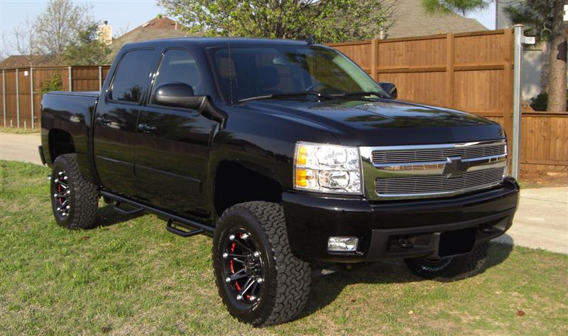

I have the outside of my truck just how I want it and just need to finalize the inside with a little better bass and sound.
