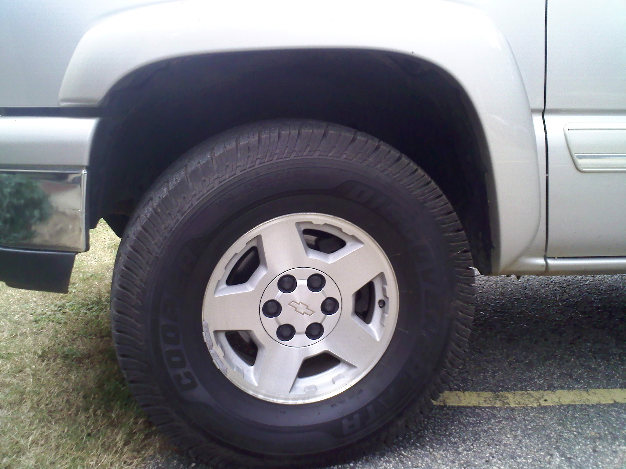

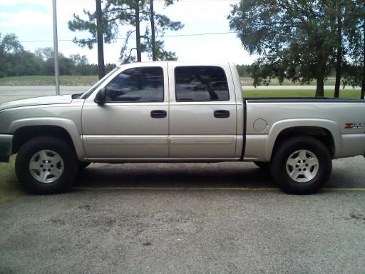

I'm running 285-70/17 (33 x 11.5) tires on stock 7.5" wide rims. I've only lifted the front end about 5/8" and have not had any rubbing issues.
im running 315 on my with tortion bars cranked just a little. only scrubbed one time turning into a steep drive way.
