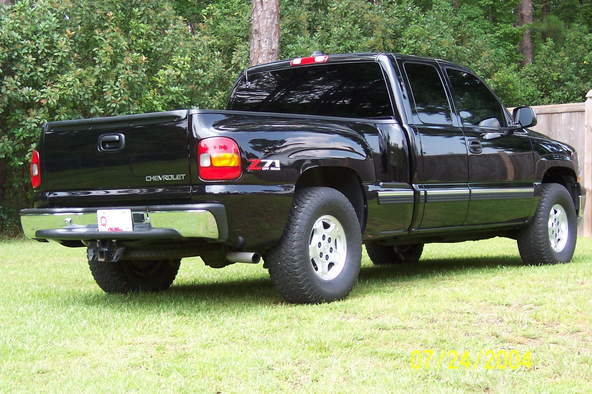

I ran 305 70 16s on the factory 2002 Z71 wheels. Put almost 100k miles on the truck and never had any problems.

The tires wore down evenly, ran about 38 pounds in each tire. Got over 60k miles on my first set of 305s. And know many many more people that also ran 305s without any problems. In my experience it can be done, and the tires wore evenly.

Just giving my personal experience, I will post pictures later
