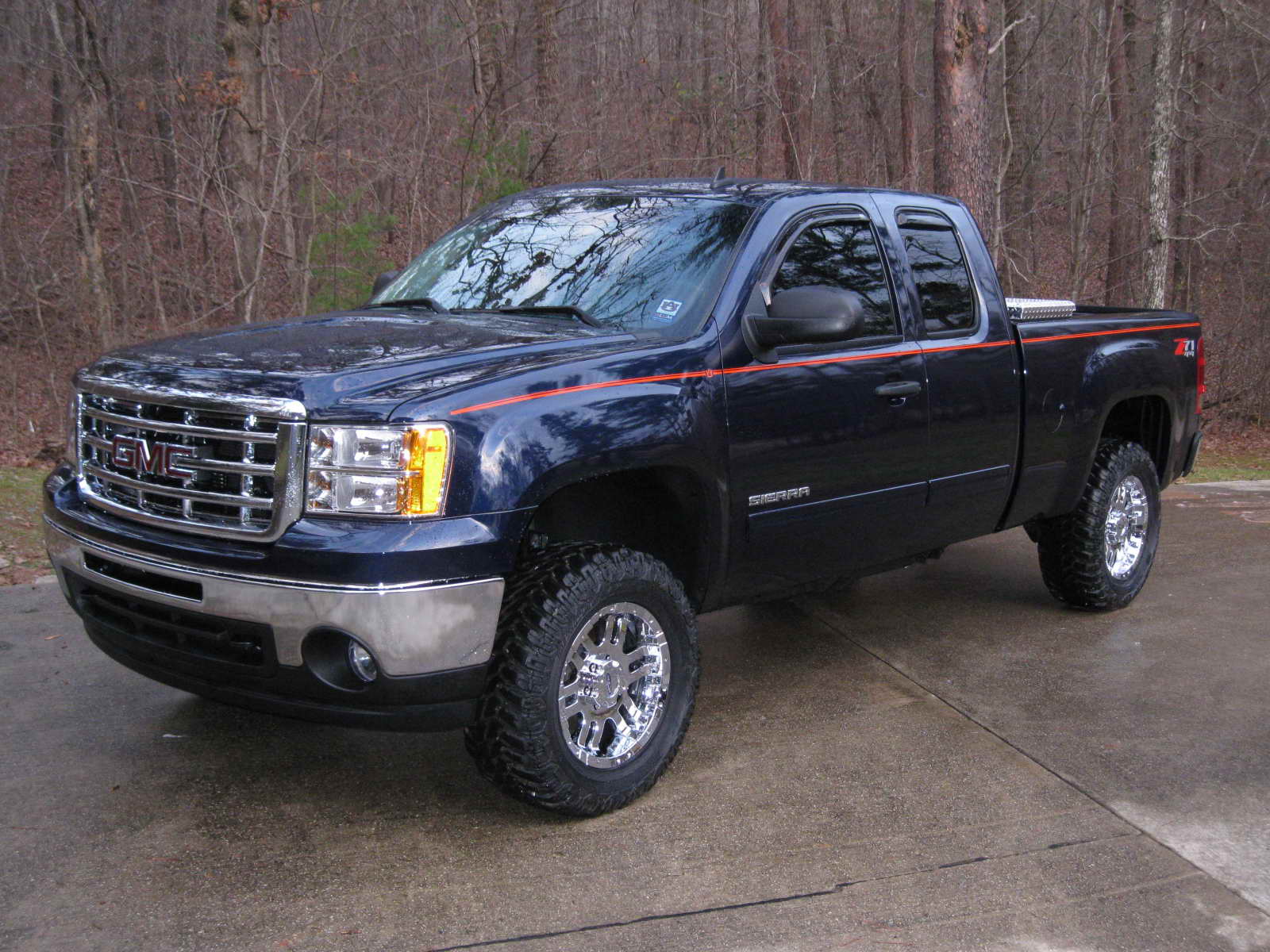

I have an 09 GMC Sierra 4x4. I installed a CCM 2-1/2" Leveling Kit and a Zone Offroad 1.5" body lift kit.
I installed a set of Moto Metal 951's in 18"x9" w/ +18mm offset, and wrapped them with Cooper Discoverer STT tires in LT305/60R18.
I really like the Cooper STT's because they are very aggressive and they do not sound like a herd of B51 bombers coming down the road. They are very suprisingly quiet, and I hear they get about 40k miles, which is better than most I have heard of.

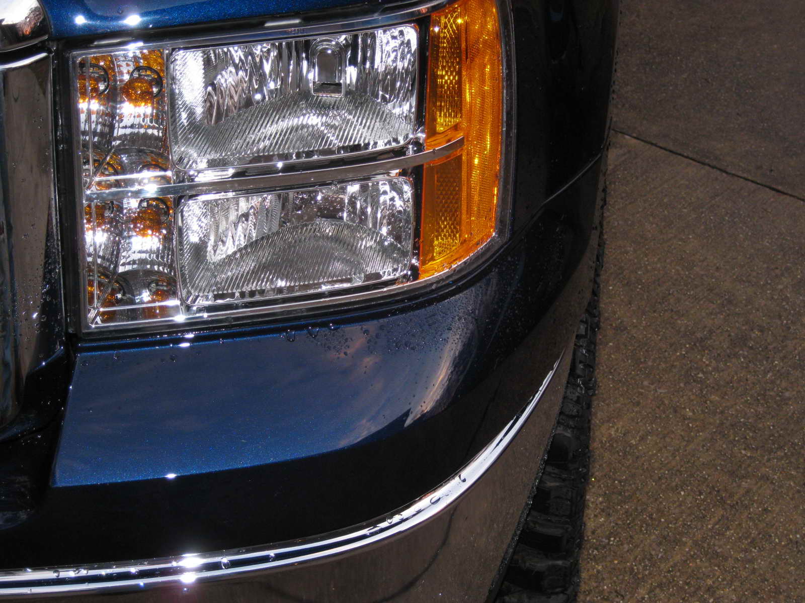

The +18mm offset places the tires about flush with the fender well. Check out the pic.
I found the best price on the wheels at rimzoneonline.com and the best price on tires at treadepot.com.
I have absolutely no interference or rubbing issues whatsoever. No trimming required.
